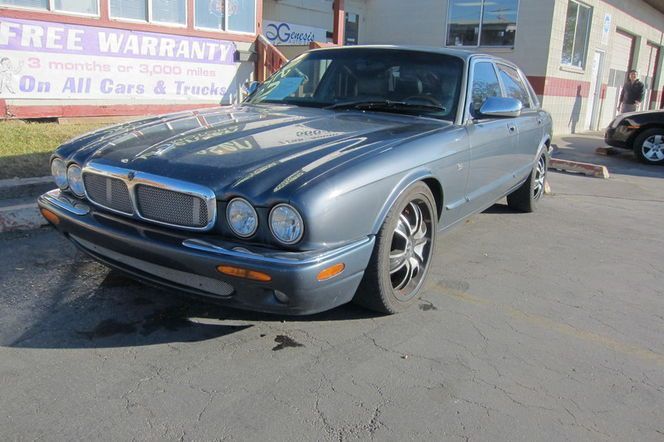

The car is about $4,500 which seems fair? but you guys will probably know this better than I do. Given it has no service history I may be able to bring it down.
Also here are a few pictures.

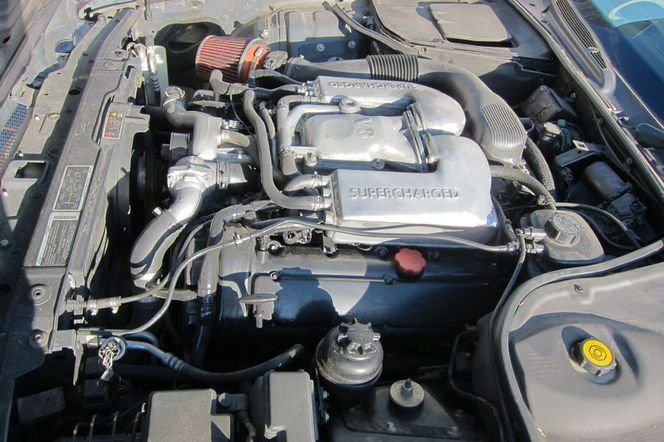

Engine is a bit dirty, but seems in good shape

I'd walk away myself. Given that there's no history, and judging by those wheels and that el-cheapo air filter thrown on the end of the intake tube, as well as the missing trim plate.. it instantly makes me suspect as to what ELSE has been done to the car, but more importantly, what maintenance HASN'T. I'd venture for the same money, or slightly more, you could find a much more reputable one for sale in better condition. Also, at a glance, tire size appears wrong. Maybe it's due to the wheels but they look way too thin. As in - owner or prior was a younger kid who had a pep boys or something near by, but not the budget to properly maintain the car as it needs to be. First impressions, but with the market of these cars, personally I'd hold out for a better example. That's just my opinion though (and I bought mine on an impulse buy, so take that for what it's worth lol)

As I daily my XJR and as I'm very familiar with the spanners on my car I'm with CharlzO - I'd walk away from it.
Judging from the engine there has been somebody fiddling around with the coolant bleeding lines at the expansion tank. Likely they had been repaired due to deterioration - as long as you don't know what's been done to it you'll soon look into a lot more repair on the coolant lines all around the engine. If the bleed lines already had been repaired due to age, then it's just a matter of time and you'll chase several coolant leaks and end up with replacing the octopus, valley and other "prone-to-fail-as-the-years-are-adding-up" hoses.
And I don't get the idea of these two bars behind the grille mesh - they're not meant to be there?!

After seeing the pictures of the after market wheels, engine, and grill, I’d pass too. Stock wheels are expensive so with those after market wheels right out of the box the car is lacking big time. And the engine, like CharlzO said, makes me think the car hasn’t been maintained properly. Wait for a better car with the right service history.

I look at that air cleaner and see an abused cat. If he will take less than $1500, maybe. What does the oil look like? Leaks, brakes, tires, -- these will easily run you over $1000, doing the work yourself. Then it is going to need fuel filter, dif lube, bushings, shock mounts, maybe shocks, A/C refill, hoses, new water pump, tower and TST. As much as I think these are really easy cars to work on, no harder than a Subaru, the parts will be hard to find and it is dirty and abused. Based on the air cleaner, I am guessing the tensioners have been renewed; the guy who owned it last is a gear head and knows cars, still: dirty and abused.

Not so sure about gearhead, myself. Wannabe, maybe. No shroud, and a pretty cheap cone filter, just tossed on, and as you said, as dirty as that engine bay is... But I agree on the valuation. Just feel there are a lot more options on the market

I wouldn't pay a dime over $2500 since you're going to be dealing with shenanigans. Sketchy wheels almost always means questionable maintenance. There are exceptions, but that rule has served me well in life. Stuff like that trash air filter and dirty engine bay, along with the grill+lower grill+mirror caps immediately sets off my piece of crap sensor.
