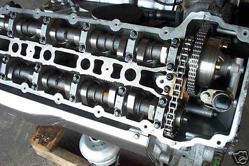

Ross,
Well, I am still baffled on the when the "final" generation of secondary tensioners were introduced.
To clarify, my engine date code is 010708XXXX thus it was produced on July 8, 2001. My car's production date (on the door decal) is September 2002 and the car is titled as a 2002 model.
I checked with the Jaguar dealer and gave them my VIN and they confirmed the engine number was the same as the one I obtained off the engine.
My engine definitely had the all plastic tensioners - thus I have a 2002 that had all plastic tensioners.
Pictures of the original tensioners in situ are in this album:
Jaguar Forums - Jaguar Enthusiasts Forum - robertjag's Album: Secondary Tensioners
There is this site:
Jaguar V8 Secondary Tensioners - Preventive Replacement
from which this quote is extracted:
"In 2005, Jaguar introduced a third-generation metal-based tensioner kit. (See the photos at left.) We now use the metal-based third-generation tensioners exclusively when replacing cracked first- and second-generation Jaguar V8 tensioners."
and "Engines subject to this problem include XJ8/XJR engines with the last six digits of their VIN numbers between 812256-F41862, and XK8/XKR engines with the last six digits of their VIN numbers between 001001-A24195."
My Car VIN is F43139 - well after 41862 but STILL has the all plastic tensioner.
So it that 2005 metal tensioner an updated version of the already released 3rd generation tensioner or actually a 4th generation tensioner (as alluded to on another website)?
It appears that I have the original type chain and not the Morse chain as picture here:
Old Oct 10, 2013 | 05:40 PM
sparkenzap's Avatar
Joined: Nov 2007
Posts: 4,502
Likes: 1,068
From: atlanta ga
Robert:
So, your engine date code is before the change date. That proves the often mentioned warning to chek engine date codes rather than VINs. So, you are right that your 2002 car had an engine with old tensioners, and I am right in the SPECIFIC claims I made. Thank you, I learned something.
BTW, your reference is exactly the one I mentioned in another thread where this came up. (It's on the internet, so it must be right, right?) The website was written by a fellow who used the handle "JohnfromCalifornia" or something like that and he referenced it several times on Roadfly. He was full of it and would never back down, although I am pretty sure he never personally tuned a wrench in his life! Again, I believe that the new style tensioners were probably offered as replacements for originals after 2005, but they certainly were used in engines before that. All X-350 s had metal tensioners and they happened in late 2003.
