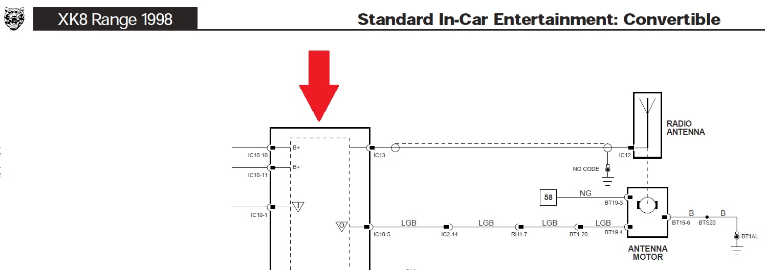

I just installed an aftermarket radio, a blaupunkt, using a convertor cable from nexxia. all fine, except that the poweree antenna doesn't come up when you switch on the radio.
I know this -old- thread is about DISableing an antenna, but how can I switch it ON?
Old Jul 18, 2013 | 06:38 PM
Likes: 17,016
Wrong forum for your vehicle but the XK8 Convertible radio installation is similar.
The switching is from the OE Head Unit output IC10-5 to the Antenna Motor.
Provided the Antenna fuse is in place, it's likely your Blaupunkt is not outputting a signal to the LGB cable.
