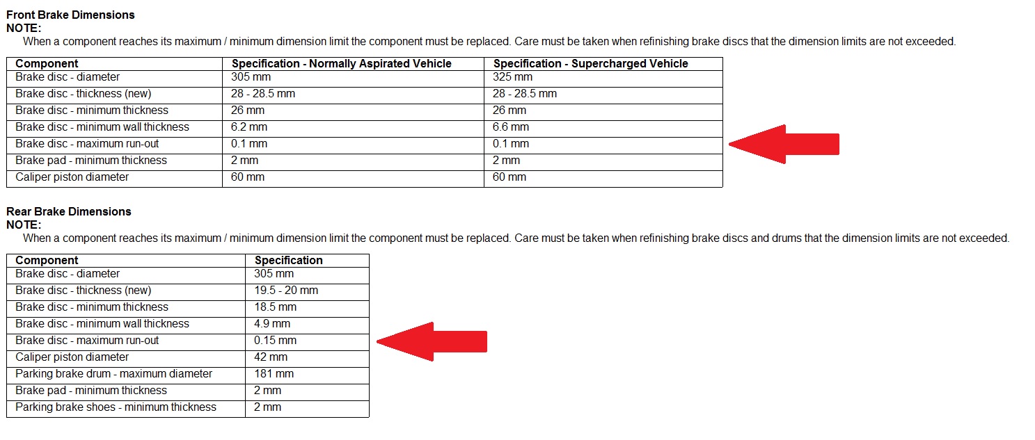

Originally Posted by osyris
.......... I refer to the JTIS software and the similar pdf version I have, it says "check wheel bearing end float, refer to specification section 204-01...check Disc Run out refer to specification section 206-03"
WHERE ARE THESE SPEC's LOCATED???...cannot find them, no numbers anywhere ..............
You will need a Dial Gauge to measure run out. Here's the specification from JTIS (arrowed in red - click on the image to enlarge it):
JTIS spec's ? Are Disc rotors HANDED left /right?-brake-disc-runout.jpg
Here is the procedure for the Front Discs:
JTIS - X308 Front Brake Disc runout Check.pdf
And for the Rear Discs:
JTIS - X308 Rear Brake Disc runout Check.pdf
This information is across three different 'brake' sections in JTIS.

Graham....
which section did you find this in in JTIS?... It says to refer to 204-01 but when I go to that there is nothing there... how /where did you find it...pages numbers please.
I have the dial gauge... how about hub bearing float specifications???
