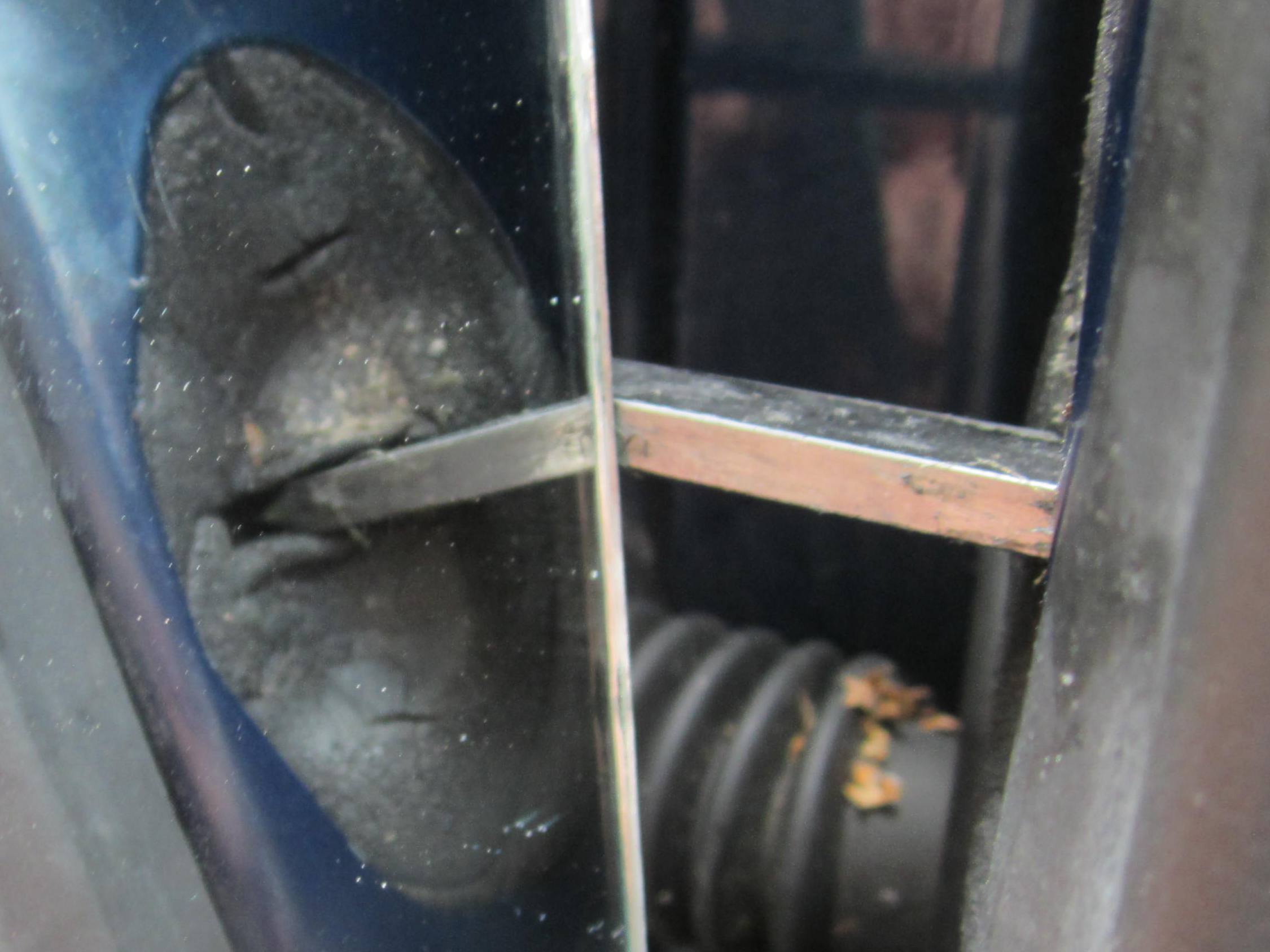

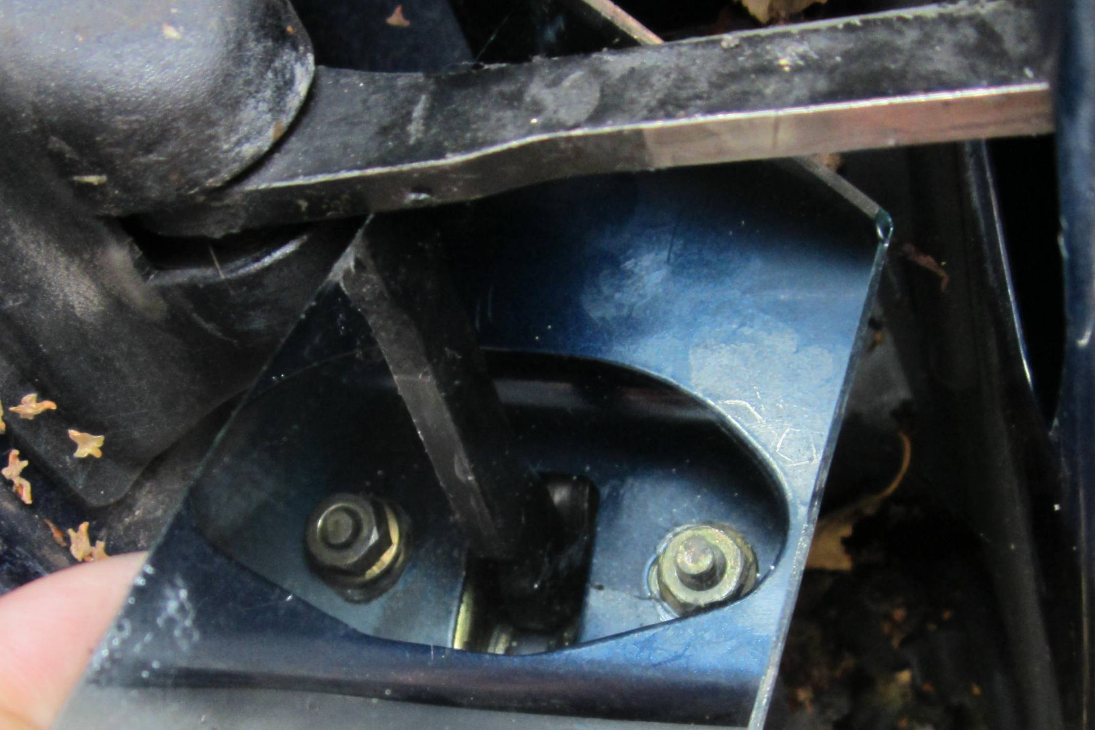

A simple fix for a potentially serious problem. I put up with the passenger door doing this for over a year but when the driver's side started doing it as well decided something had to be done.
I've attached a couple of pictures taken through a small mirror of the foam and the bolts that need to be tightened. A crack in the metal support is evident.

Pulled the foam out and, using a mirror, saw that there was already a washer under each nut....someone had been in before me....
But, with the trusty 10mm socket, I managed to nip up the top bolt and discovered the bottom one was loose. Tightened that, and centred washer and all is silent again.
