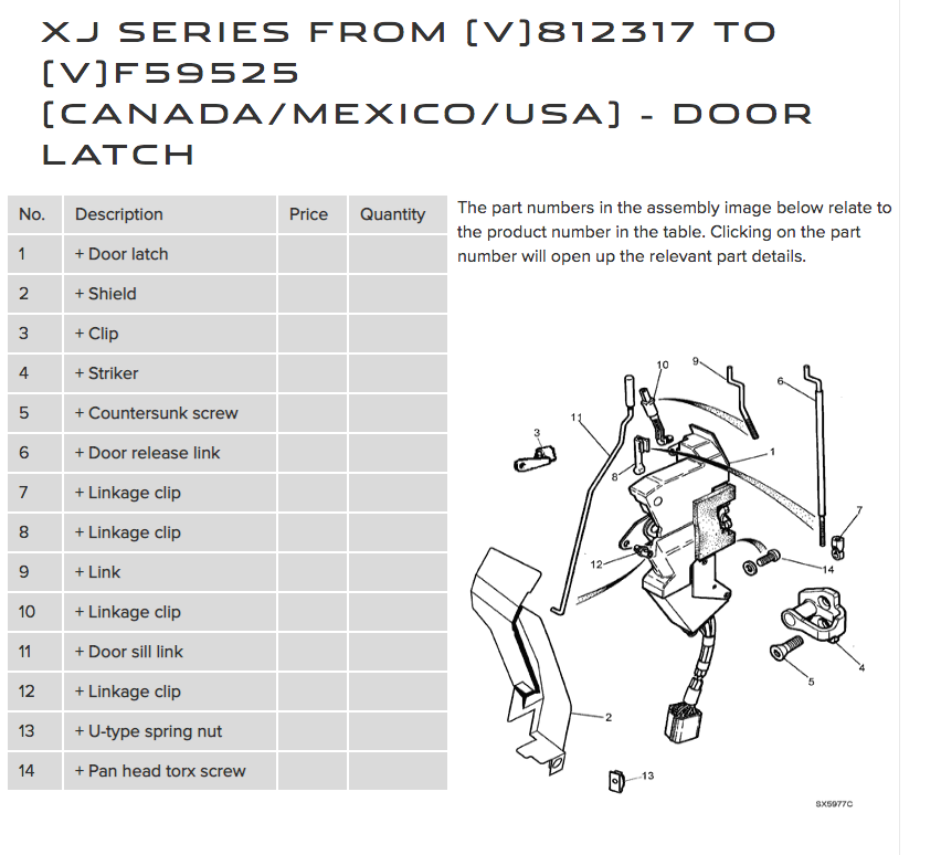

I think you have disturbed the microswitch on the door latch (part 1) shown in the schematic below
The inside handle cable linkage as well as the other opening mechanisms operate a switch that is part of the latch assembly. I think you should be able to manually test with the panel off to see if by pulling on the cable you can hear the switch operate. If you are lucky, you may have a cable that is going to the dark side and isn't able to rotate the linkage enough to operate the switch
Elsewhere on the forum there are posts on successes with replacing faulty microswitches (I have replaced units on the trunk latch and brake switch successfully and found what I needed on Digi-Key).

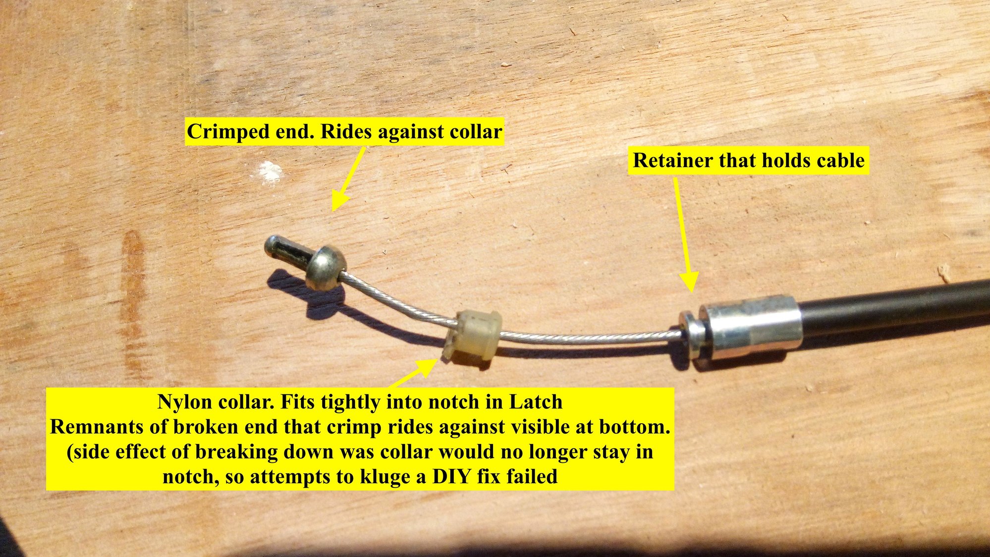

Got to thinking of this more as, sods luck, I found the ft passenger door wouldn't open yesterday just after I repaired the drivers door, so I've just been looking at what caused the problem. Problem was it wouldn't reliably open the door from the inside handle (in retrospect it was likely going bad for a long time and we hadn't noticed that the action of the door handle had changed as the car gets little use these days so there was no point of reference to show things were changing until it stopped working).
This time it was the cable that was bad. There is a collar that sits on the cable at the latch end of the cable that I found had disintegrated. The crimp at the end of the cable sits against it and forms the surface the latch arm acts against as you pull the interior handle. The collar is nylon / plastic (not sure what it was as it was in bad shape). Even though the collar is only 1-2 mm thick where it sits against the cable crimp, this was enough for the door handle to stop working. There are lots of posts on this problem on the forum....
To your issue - After pulling everything apart to see how it works, it seems that all the linkages for door operation (inside handle, outside handle and manual door lock plunger) all operate the same mechanical spring in the latch that affects door opening and locking. In turn, all of them connect electrically to the microswitch.
I think that this means, in your case, as the fob operates the lock that your microswitch is good. A final test is that if you can unlock the door via the plunger, then this points to the problem being with the cable (both front doors are similar as far as I can tell).
As FYI, I tried to fix a temp solution to replace the collar, but gave up and have just ordered a new cable from Amazon. I think that may be the solution you will have to follow as well

Default Replaced Front Door Cable - Fixed - Door now OPens from inside
Have posted earlier in this thread about the front passenger door not opening using the inside handle on my 98, so this post closes the loop on the repair.
The new cable arrived this week (was a URO part).
Installed it and now all is OK.
Wanted to share to show the cause of the failure - in the attached photo the collar that the latch end cable termination pulls against can be seen. It is nylon and the end that the cable termination rides against had disintegrated. Otherwise, the old cable was fine. This collar sits (very tightly) in a slot on the latch mechanism and is the point the cable crimp rides against when the door is opened. Just by losing the small portion of collar that the cable pulls against was enough that the handle would unlock but not open the door.
Replacement was about as difficult as changing a brake or shift cable on a bicycle. I found that I needed to remove the latch from the door to seat the collar properly as the collar is a tight friction fit in the cutout and I couldn't get it to seat fully when still on the car. The latch comes off with the removal of 3 Torx screws that hold it in place. To fully remove it from the car, you must also move the window guide to make room. It fastens with a single Torx screw at the bottom that holds it in place. The arm that connects to the outside door handle must also be removed (I found it easiest to remove the handle to disconnect it (2x7mm bolts and then rotate to unclip the latch arm from the handle). Otherwise, the most difficult / time consuming part of the job is taking the door panel off.
Total job, going slow, took ~2 hours. Now that I know what the job is about, doing another door would take ~ 1 hour.
Part cost ~35 USD delivered from Amazon (I ordered it from the States as the part wasn't listed on Amazon.ca and the eBay listings were also all US, but cost more shipped to Canada). The nearest dealer is a couple of hours away, so I never checked the price from them as I wasn't going to be travelling that way for a while but as FYI my last few parts (all engine bits) have been cheaper from the dealer than I have found online.
Latch end of Cable showing failed collar
View of the entire cable

Thank you for this informative post with great pictures. I suspect the problem I had all along was that the nylon collar was not seated well in the latch arm recess. Of course I found this out AFTER going to the junkyard and buying a replacement latch assembly because I thought the microswitch was bad. What I have learned here is that when replacing the cable, everything in this assembly is precisely related must go back exactly as Jaguar intended which is not obvious when looking at the broken pieces.
