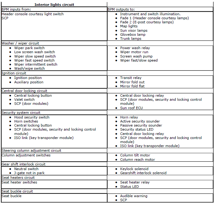

I think you nailed it, just had a read through the service manual and everything that stopped working is on the list as being controlled by the BPM. I will pull it apart and inspect for any dry joints..

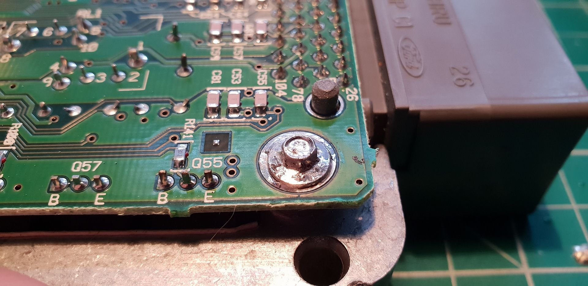

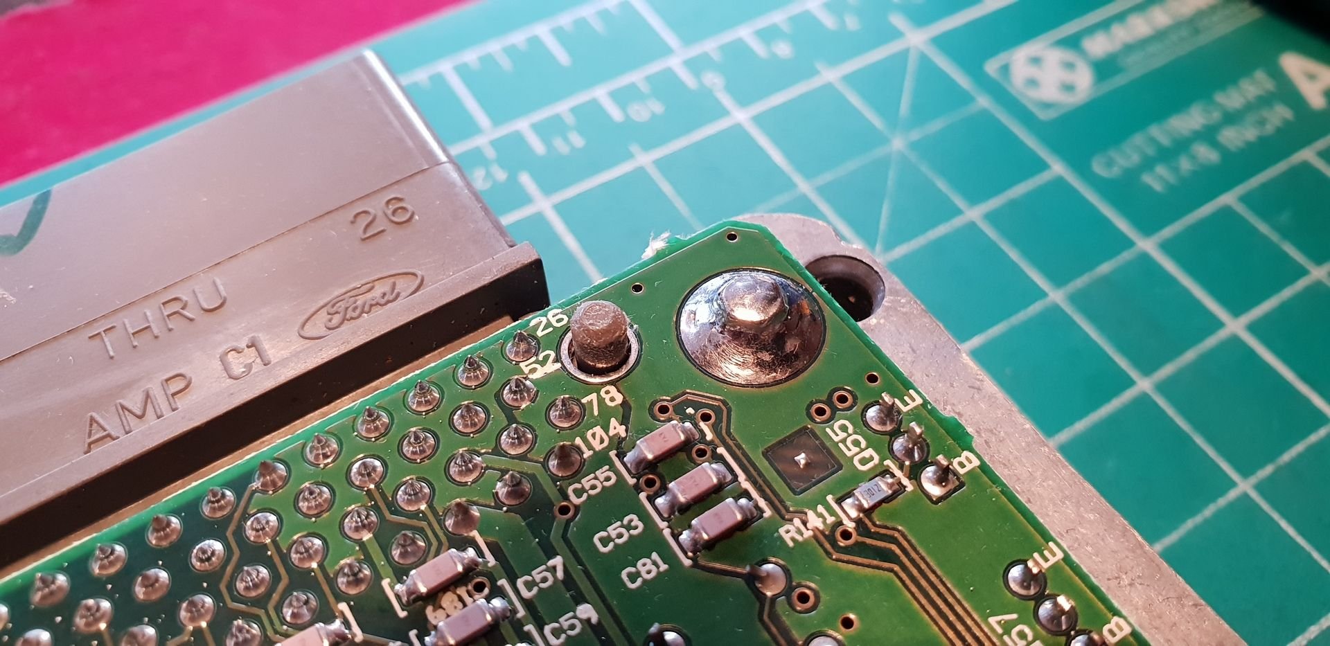

I assume these are the earthing points you are talking about as they were badly cracked. Its all back together now so time will tell if that cures it.. so far so good.

Those are the ones. Great job. Hope it all works out.
