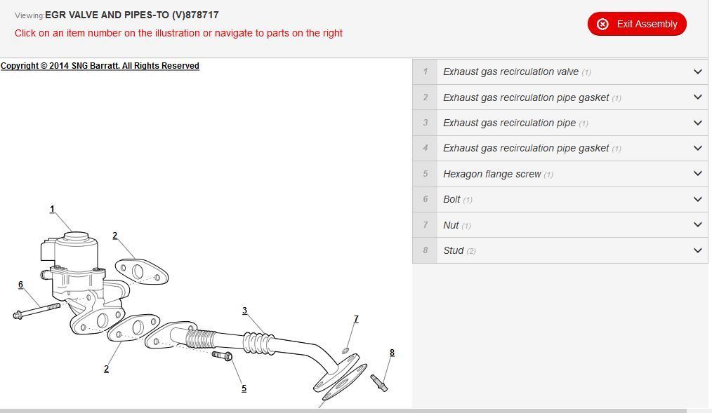

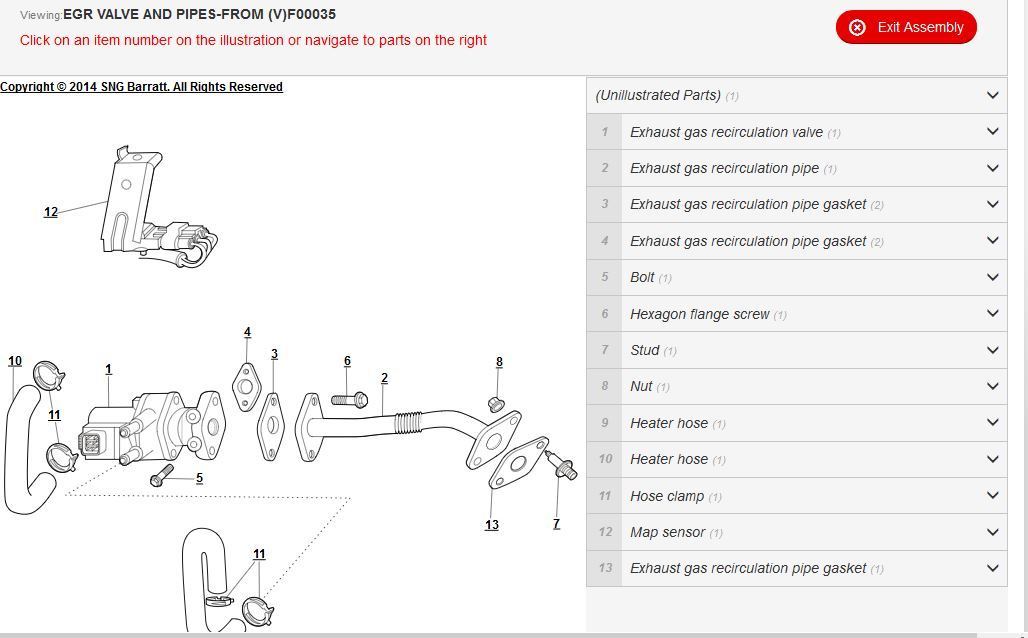

Looking at your screen shot you have as stated before a vacuum leak with the P0171 and P0174. If you combine that with the EGR and MAP codes your leak is most likely from the pipe or gaskets for the EGR. They are a known weak point. The parts are fit by the last 6 digits of the Vehicle Identification Number. I have posted below the 2 variations of the EGR based on VIN.
You can follow this link to SNG Barratt and download their free parts catalog. https://www.sngbarratt.com/us/#!/Eng.../43/all/1/10/1
The advice on sending out the ABS module sounds like a good starting point.
My approach would be to get the EGR code straightened out and then clear all of the codes and see which ones return. EGR leaks can cause lean condition and manifold pressure problems. It is best to solve one code at a time.
