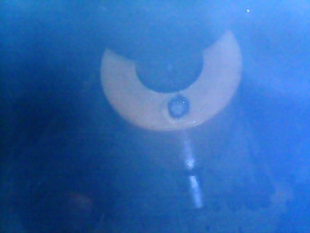

I have some additional input to this issue. I was doing some other repair, replacing heater pump , and had to remove the coolant expansion tank. I found that the previous owner (or thier shop) had disconnected the level sensor and put a shorting wire in the connector to bypass it. I removed the sensor and found that it was working OK. I found out that the float inside the expansion tank no longer floats so it is always at the bottom of the tank. So the solution in this case is that you have to replace the expansion tank since the float is built into it. I tested this by filling it with water with the sensor in place saw that the float did not float (it was not stuck and does moves smoothly up and down) and when I manually moved the float up by hand the sensor switch closes as it should. (closed = full, open = empty)
Here is a picture of the float that is inside the expansion tank, the dot is the magnet:
Attached Thumbnails Engine Coolant Thermometer Sensor?-xk8-coolant-sensor-float.jpg
