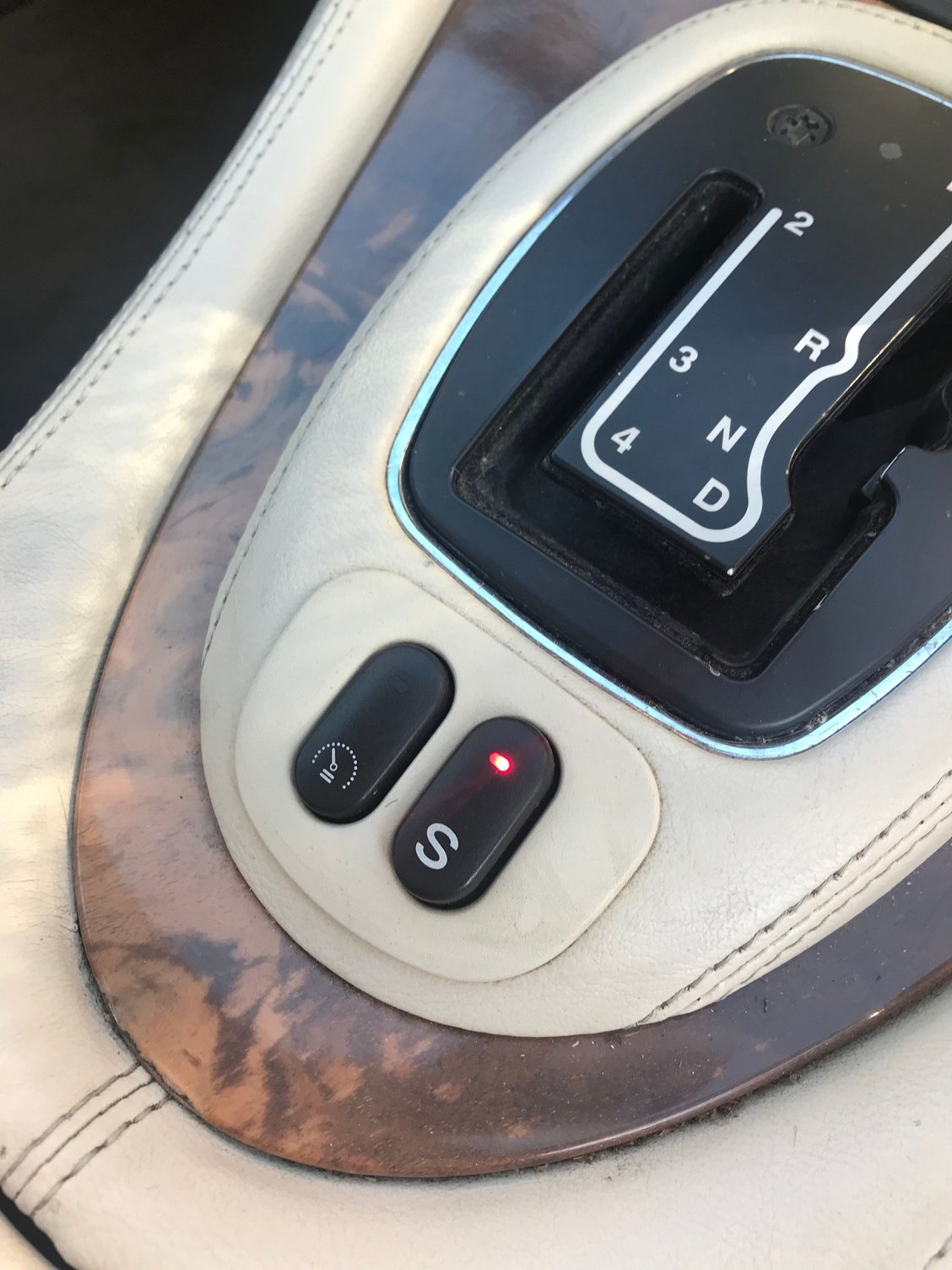

So the cruise control won’t work anymore, completely fine before the fuel pump died, any ideas? Could I have hit a wire in the boot maybe or something like that? Thoughts are welcome before I start a new thread 😂

I hope its not the clock spring or multi function handle switch? But as you know to do, check the relays and connections.

Don’t suppose you know where they’re located? Are they next to the fuel pump relay?
It could be the cruise cancel switch at the brake pedal. See this thread (https://www.jaguarforums.com/forum/x...n-light-76654/) and search for more.

I’m not even going to say anything except I’ve no idea how that happened, I’ve pressed that once in 6 years and that was to switch it on 😂 always check the basics first guys
Pleased I read other people’s threads before I did something silly
