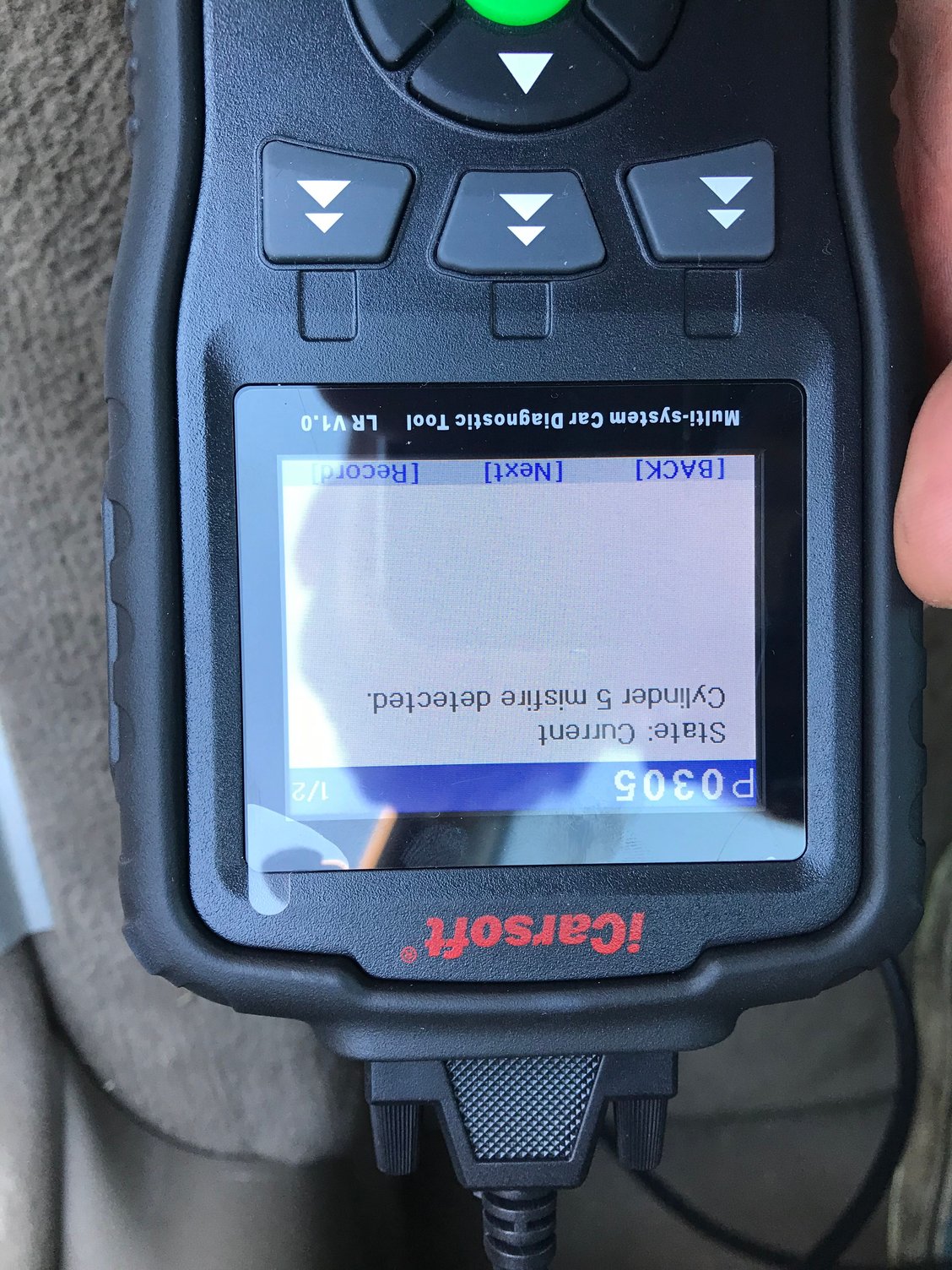

Old Jun 25, 2020 | 12:26 PM
dangelous's Avatar
Joined: May 2019
Posts: 88
I’ll have a look tomorrow
