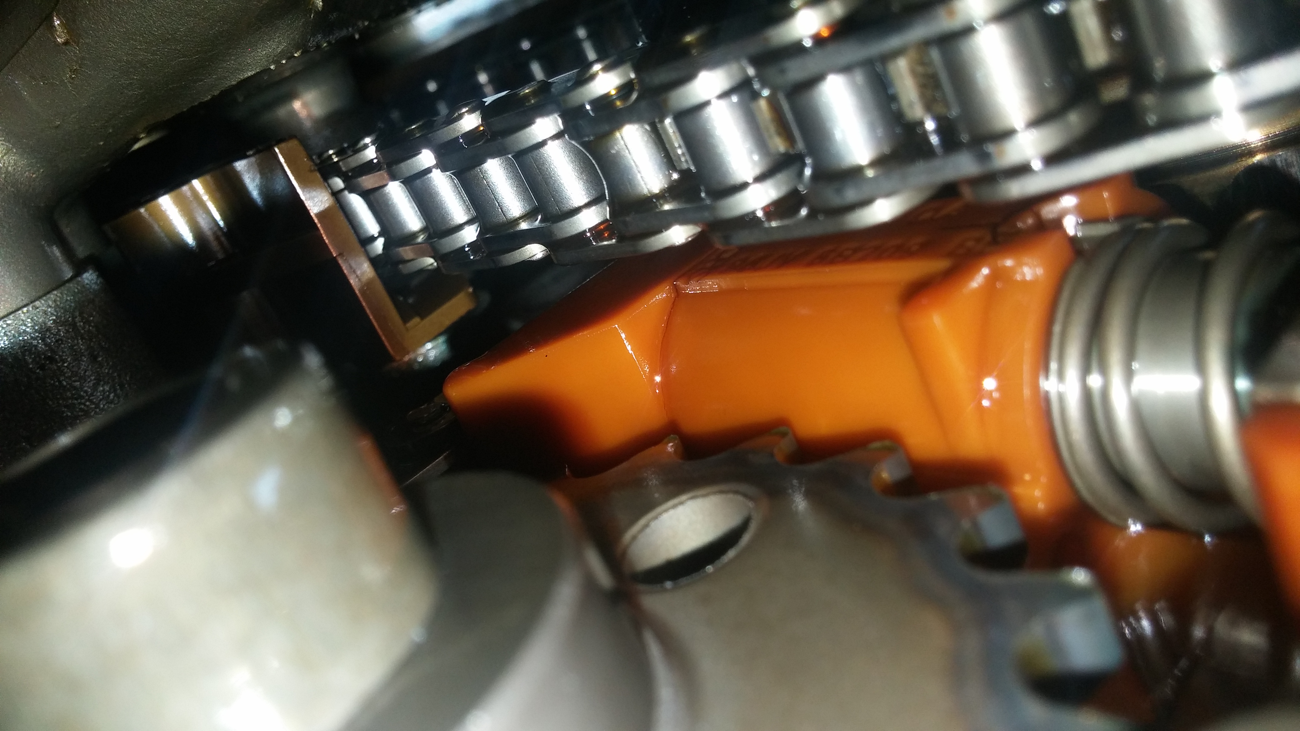

Finished changing the secondary timing chain tensioners.
Just under 58,000 miles
Just the startings of some tiny cracks, hardly worn.
http://i1295.photobucket.com/albums/...pscmn6mspv.jpg
I must say, it is much easier doing anything under the hood without a super charger and the requisite accompanying spaghetti in the way.
Fortunately, the install went very smoothly, everything co-operated nicely.
http://i1295.photobucket.com/albums/...psks4z9byo.jpg
http://i1295.photobucket.com/albums/...pskbz95jzs.jpg
http://i1295.photobucket.com/albums/...psdund23lb.jpg
A big thank you to Buck for his help.
A good tip from Buck if you are going to do this yourself was to spin the motor until none of the lobes on the cam are pressing on any lifters. You can check if you are in the right spot by sliding a piece of paper between the cam and lifters. This way the cams come out and back in very easily. We used a sharpie pen to mark the cam position so we knew we did not somehow jump a tooth (yes we used multiple zip ties).
