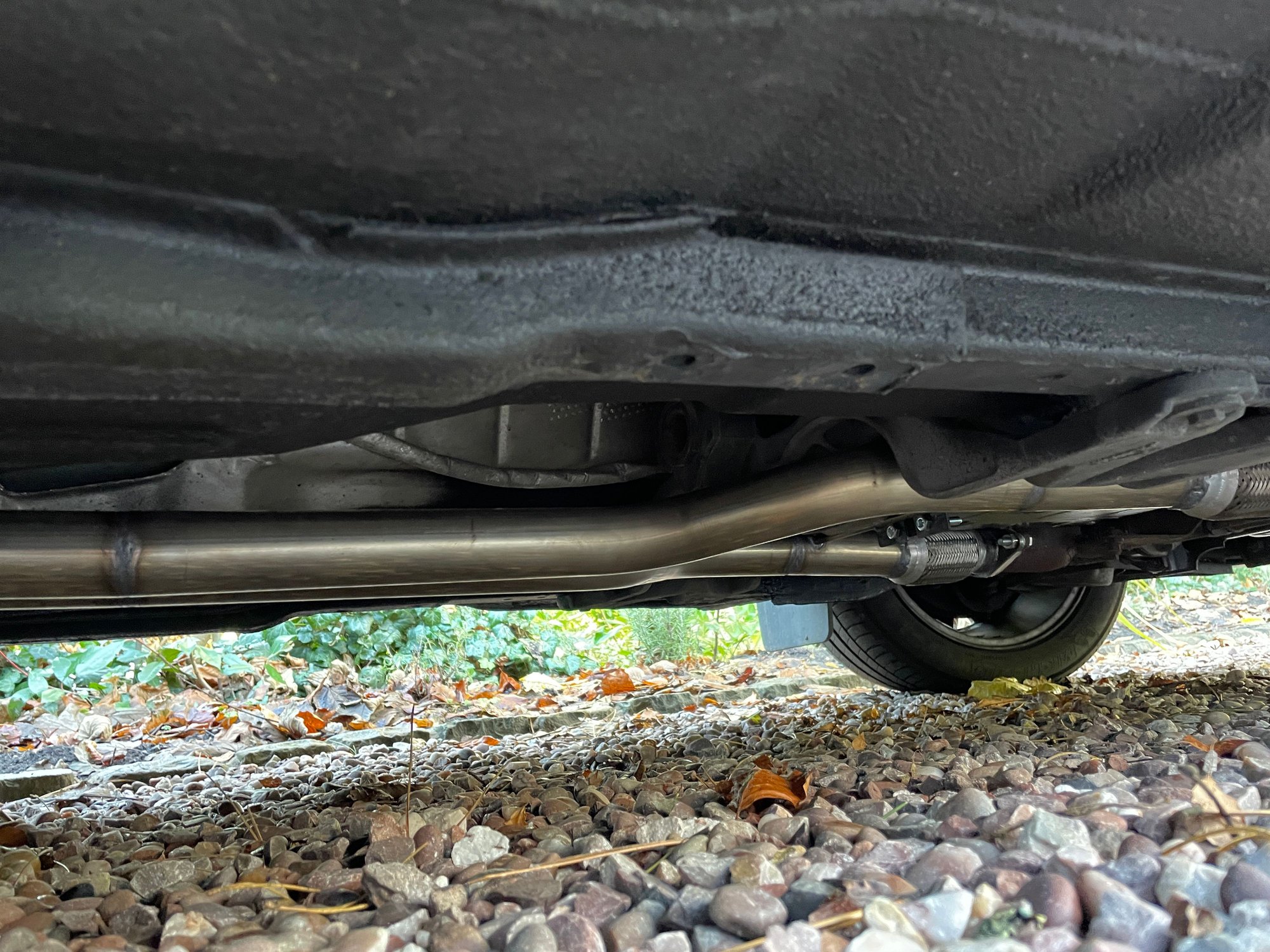

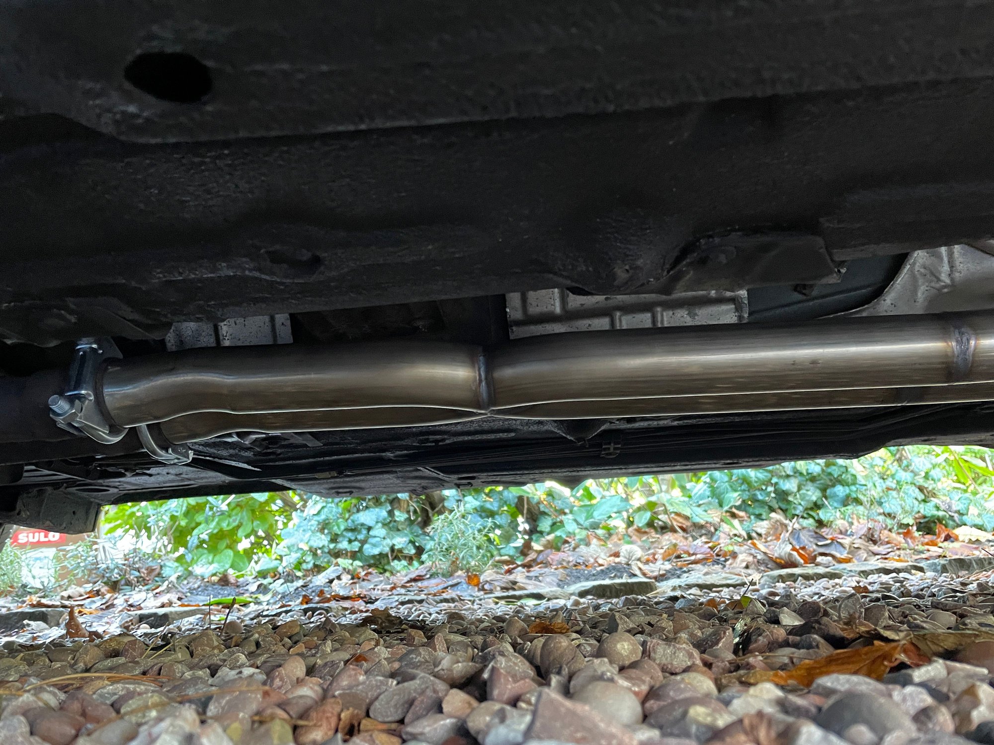

I have a system on my car from Paramount Performance here in the UK. It keeps the standard centre box but deletes the pre axle silencers and has differently designed back boxes. The system works perfectly, a nice V8 beat on idle and the V8 music when accelerating. But by far the best and perhaps most bizarre thing is that at exactly 70mph it’s silent. The UK motorway speed limit is 70 so on long journeys on cruise control it hardly makes a sound unless you hit a big incline, just no droning.
The system is really meant for XJRs and my little 3.2 doesn’t really do it justice. However @Sean B B has a similar system from Paramount on his XJR 100 and that sounds an absolute beast!
