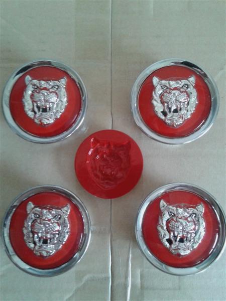

Recently asked if some one had re-conditioned his hub caps, to no avail.
As I really wanted to stay with the original Jaguar ones, opposed to the cheap(er) later versions or the Chinese knock-offs, decided to go ahead with my faded (pink in stead of red) caps.

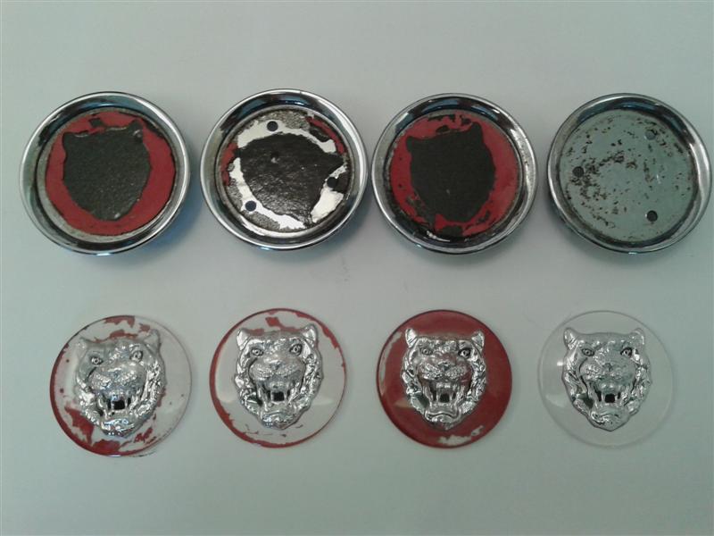

Took them carefully apart with the help of some heat from a hair blower, then cleaned the remains of the double sided tape and old paint.

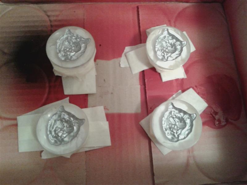

Sealed the chrome leaper (to protect any tiny holes in the chrome becoming red spots), then painted the inside with 3 layers of red.
Finished with installing them back in the housing with some thin, 3M double sided tape.

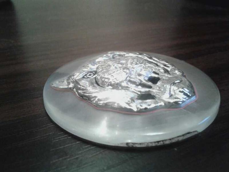

By the way, as the cover is transparent, you can think about other backgrounds then just one plain color ...

Nice. I'm going to try this as soon i manage to get my wheels off the car
How did you get the red paint off without scratching the plastic?
Wet sandpaper, laying on a flat surface, just circle the caps around on it.
It comes off quite easily, then use super-fine to prep before painting.
Most important is the to seal the chrome though, hold it against a strong light to see any damage which you will need to tough-up.
As you can see, I had one ''try-out'' cap, which was missing the chrome on one ear, and used super shiny flaked chrome nail polish to repair.
Invisible repair!

Originally Posted by Don B
BTW, was your plastic in good shape or did you polish it with something like 3M Plastic Polish?
The plastic of the caps was in very reasonable state, but I indeed polished the outside after all painting was done.
I also cleaned and polished the chrome rings.
The picture still shows some pitting in the chrome, but this is hardly visible in real.
It is very hard to determine how far you can go before ending up with the plastic color ....
