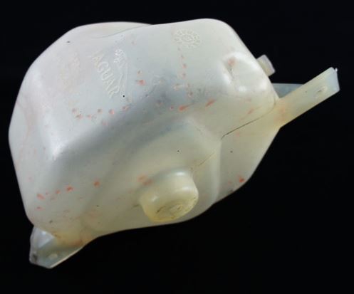

Here is a photo of the recovery tank:
I hope this information answers some of your questions.
