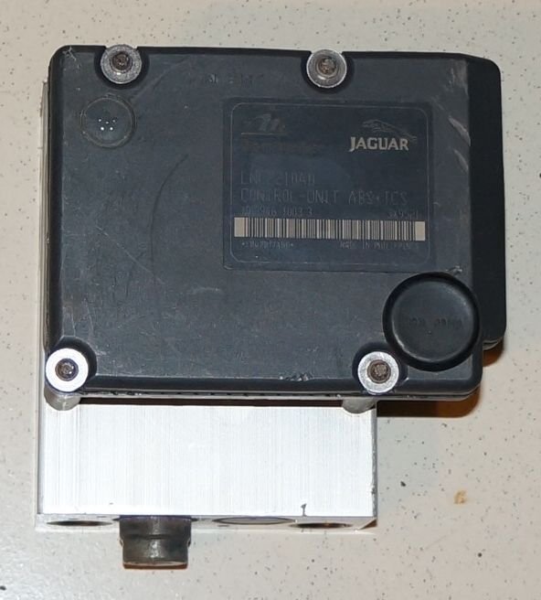

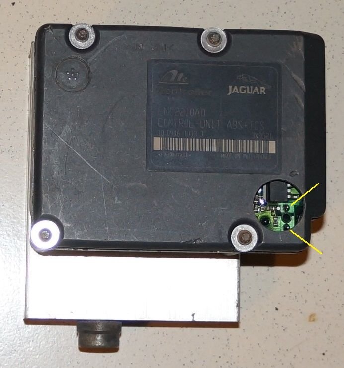

The "corrosion" seen is just rust residue from something corroded on the other side of the ABS. The 9 "plugs" are solenoids, coils imbedded under the blue plastic, that activate the valves in the valve block. As longs as the solenoids inside are good, any dirt outside will not affect them. You can just clean/brush it off. The concern here is whether the solders on the PC board inside the module are good. Most common failure are the big solders on the two large pins that provide power to the ABS pump. One way how these can be re-soldered without cutting the box open:
