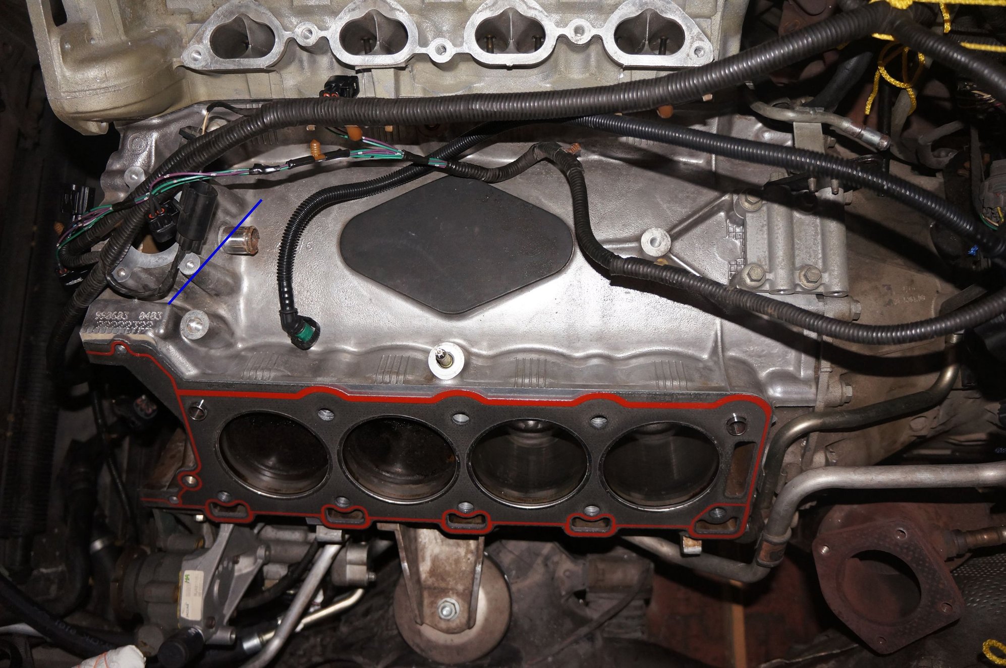

The engine number is actually the date and time when the engine was completed, i.e. YYMMDD HHMM (second MM being minutes) so you should be able to know the engine date from the car documents. It is much better if an engine up to August 2000 is replaced with a later one as it will be with steel liners, not nikasil. The first steel-lined engine came off the production line in the year 2000 on August 18th at 10.43am with engine number 000818 1043 so you should be looking for an engine number higher than this. Otherwise, the engine number (date), on my 1999 supercharged engine, is located as shown on the picture.

...and the location of my 2000 XJR's engine code (30 August 2000) is on the driver's side of the block (LHD) below the exhaust manifold right between the engine mount's bracket and the block's coolant drain plug. For a long time I couldn't figure out where it is but when I was overhauling my front axle I discov it with the front subframe removed from the car.

Do i need to take anything off to get to this location?
No, but you will need an LED penlight to shine on the number (and possibly a small piece of cloth on a stick to wipe the area). You can only see it from a particular angle standing at the right side of the engine compartment. It is on the small shiny shape you can see on the picture, below the hose elbow (pointed at by the red line). If, however, the engine is later than August 2000 (post Nikasil), the number is probably at the location described in Post 12 (you will need to look from under the car). Otherwise, the usual reason for replacement of pre-August 2000 engines was failure of their Nikasil liners.
