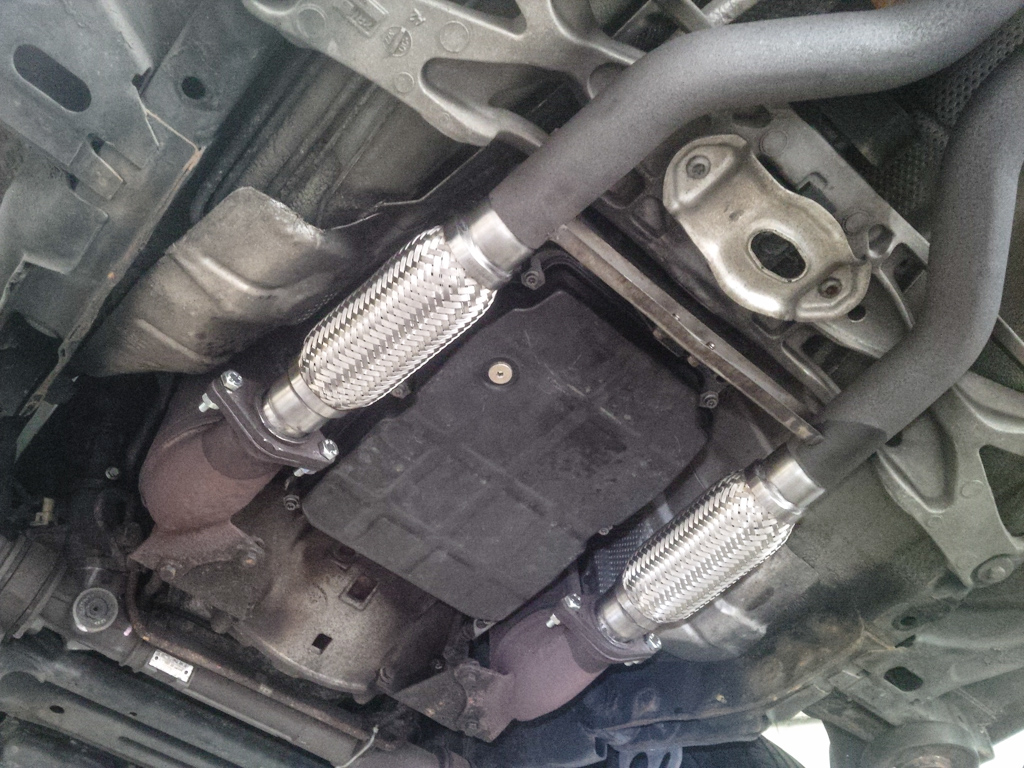

Hi,
yes, an universal flex hose will do the job. I did replaced both sides a few weeks ago. Unfortunately I can't find the dimensions that I measured when I did the replacements.
But here's a picture off e*** with the dimensions of the universals that I used for my MY2000 XJR.
I used new gaskets as well but had to use additional sealing compound as the gaskets didn't manage to seal it properly.
I cut the exhaust right behind = downstram the flex hose, broke loose the bolts at the cat and flexed off the flex hose at the connecting piece to the cat.
After grinding down one side of the universal it fitted perfectly in the connecting piece. After cutting both ends to size each end slid easily into it's position, so I could weld it.
See attached pictures for condition before and after welding.
Attached Thumbnails hard to find gasket-uni_flex.jpg   hard to find gasket-img_20170506_143158.jpg   hard to find gasket-img_20170506_172105.jpg
