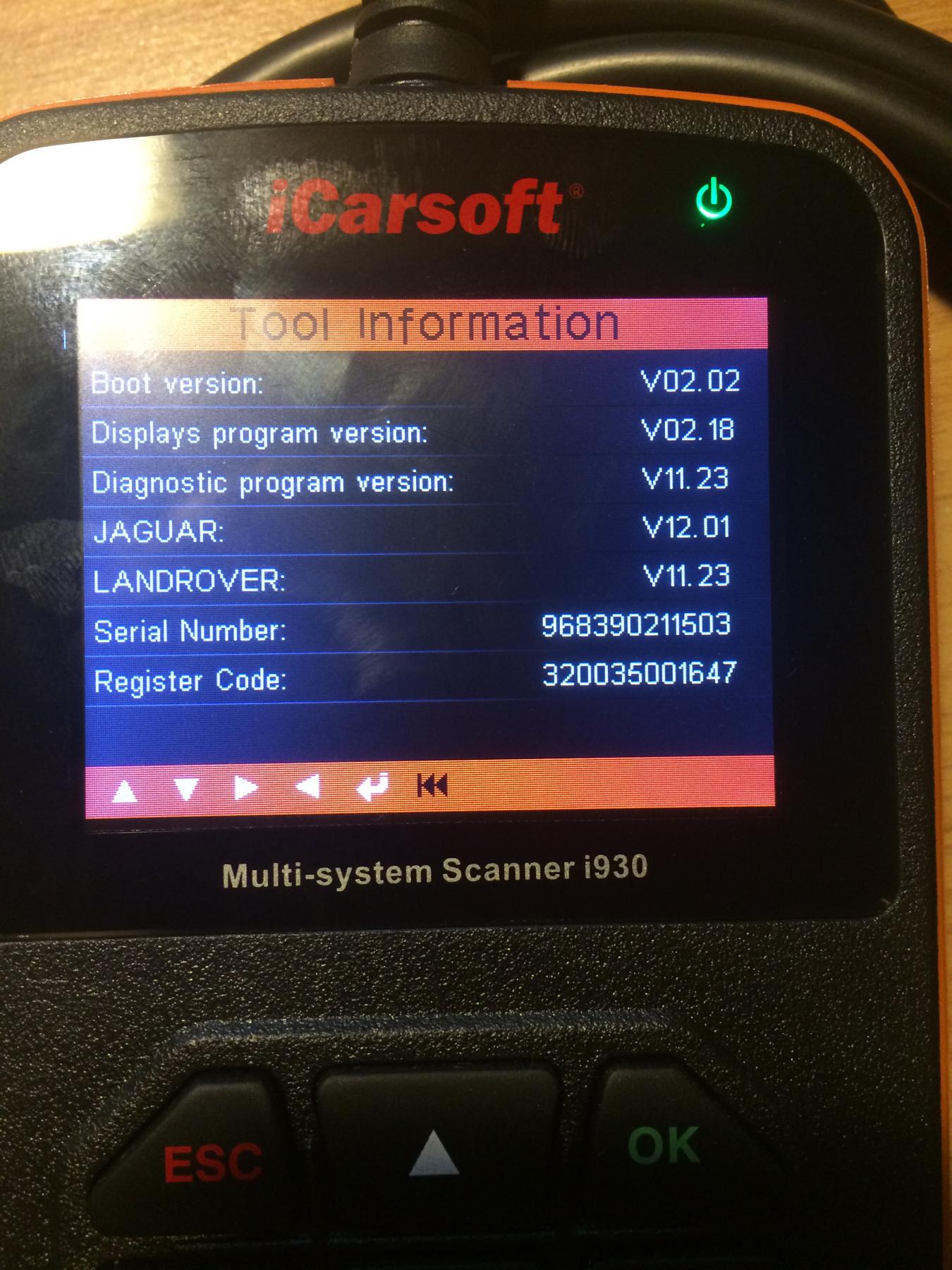

Hi puddled
Please look at this snapshot I took with my digital camera of the Help - tools screen - showing the software revisions that are on my i930 scan tool:
Please compare the revision listing with the ones on your i930 scan tool and let me know if they are the same. If not same, I need to know what is different.
Jim Lombardi

Here are the details from my scanner. Hope it helps
Attached Thumbnails Have new scanner (iCarsoft i930 for Jaguar XJ) need to test it on another X308-2015-01-29-20.54.26.jpg
