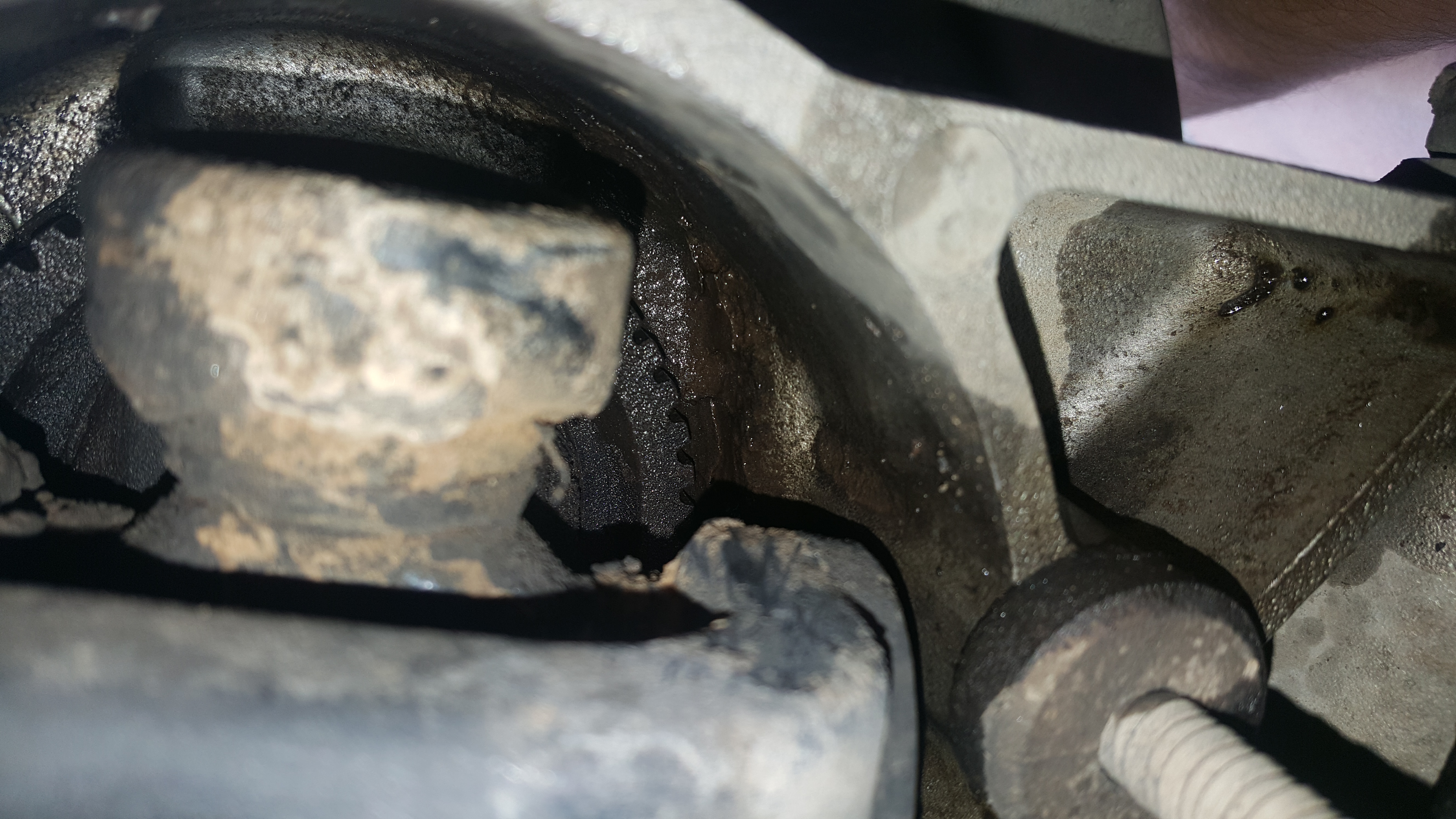

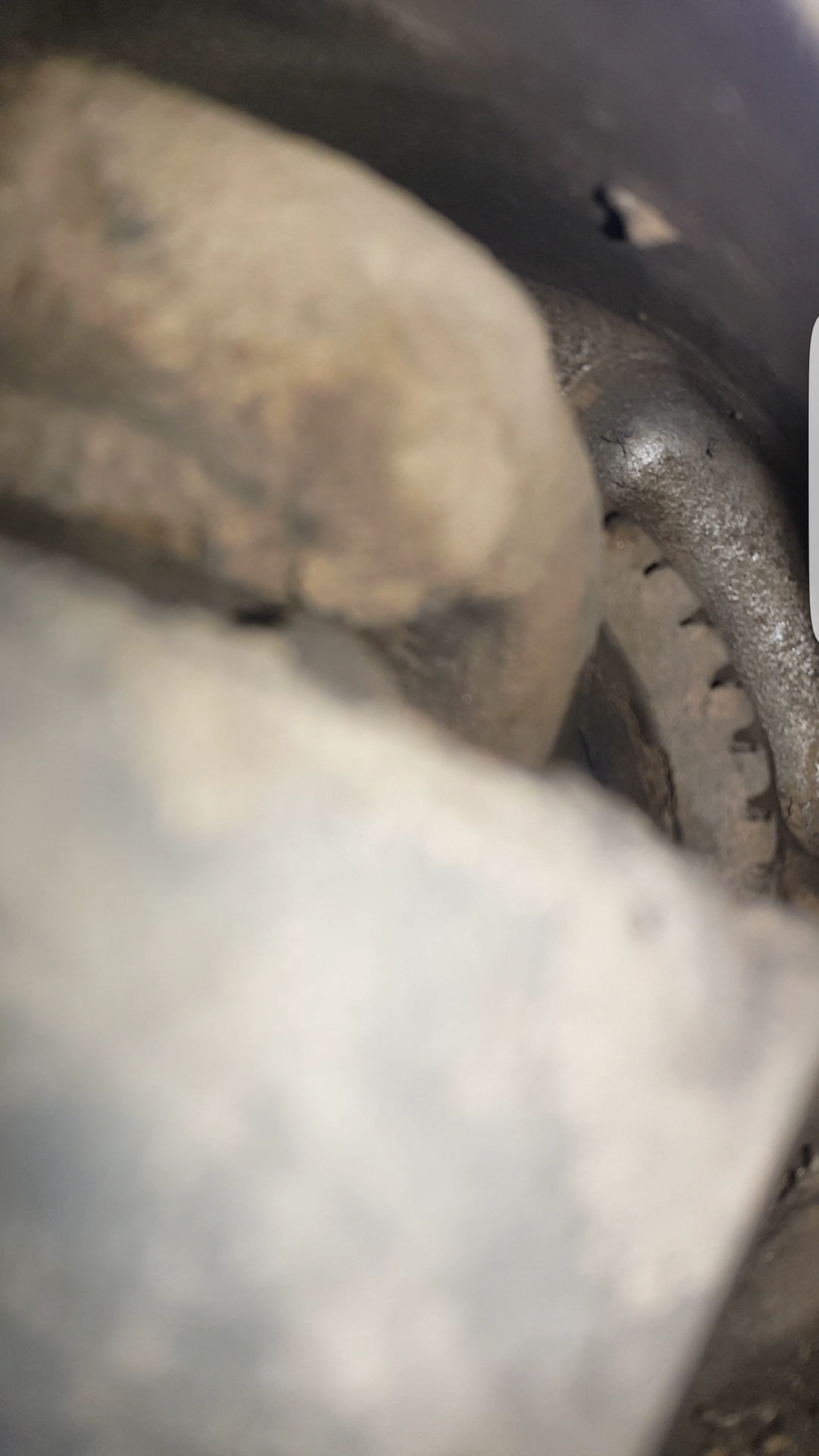

So I followed Sean's advice and took the abs speed sensor off and took a peak through the hole and the ring looked dirty and seemed like it was in contact with the wheel hub. I took a flat head screw driver and attempted to move the abs ring away from the hub and I did notice that it moved slightly. I then cleaned it with some WD-40 and with small air can and attempted to move it with a screw driver again, but this time it seemed like it was where it needed to be.
I test drove it, and NO noise. It's gone. I can finally open the windows without being annoyed!

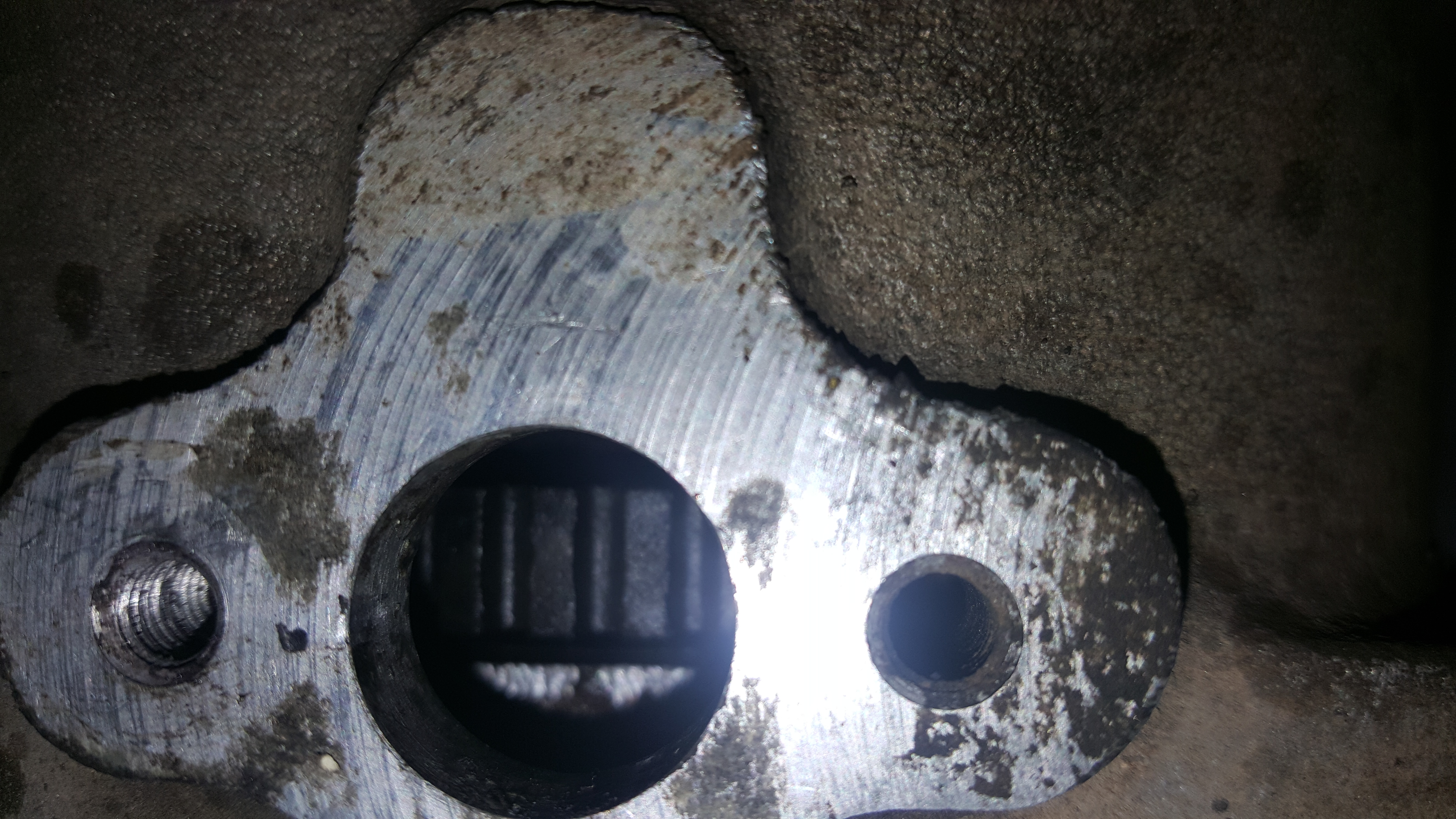

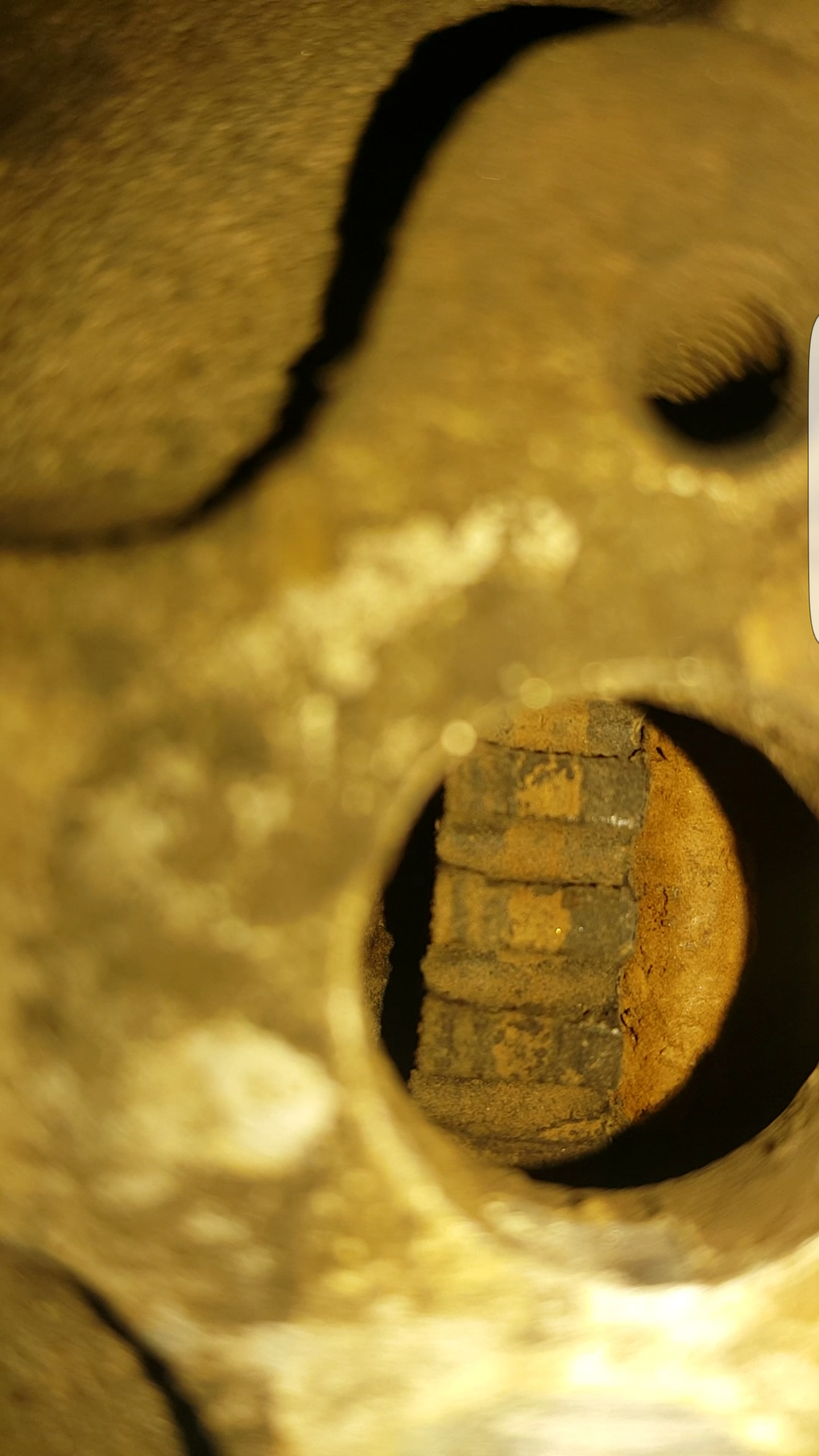

Sound came back after a few days. I have since then cleaned between the abs ring and the hub further, greased my cv joints on both sides of the half-shafts, and the noise is still there... Today, I lifted the rear of the car by putting jack stands on both sides and put the car in drive and could hear the noise again. Pitch doesn't really change with speed, neither the loudness, but it seems that after reaching 10-15mph, it comes on. The noise definitely is on the wheel part on not the differential. But I think it is internal since I sprayed a small amount of WD-40 on the brakes and behind the wheel where the CV joint is and didn't change the sound.
I took the wheel hub assembly off the control arm and unscrewed the bolt that tightens the axle to the hub, and couldn't budge the axle off the hub assembly. Is there a special tool for this, or is it just a matter of forcing it out?
At this point, I don't know what it is. It definitely is internal, so the half shaft may have bent, maybe the spindle? I spun it freely by hand and found no play or grinding noise, so I don't believe it to be any bearings.
I might just buy a whole hub assembly and half shaft because it really is irritating.
Sorry for the false alarm, but any help/suggestion is appreciated.
