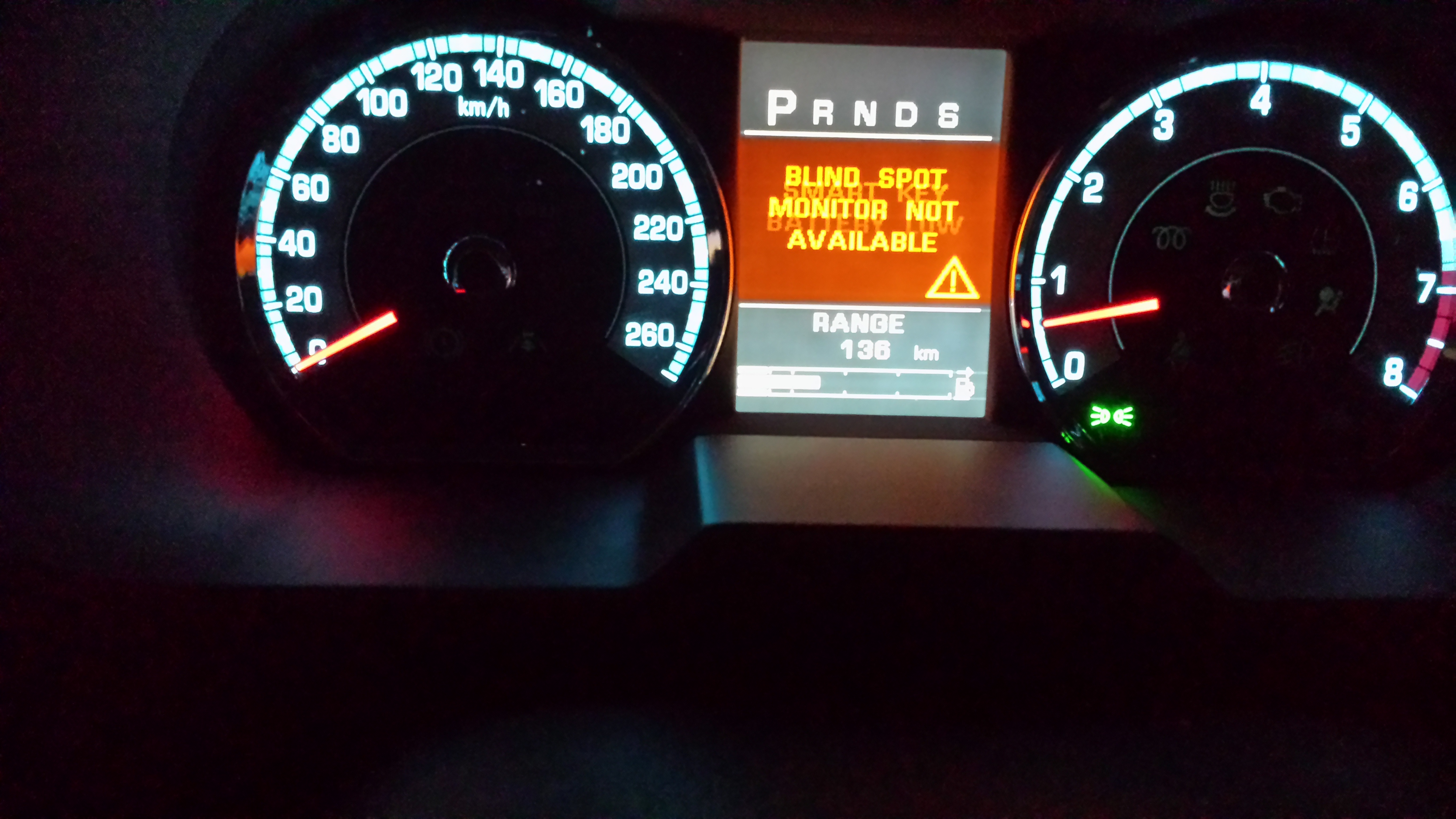

Second issue is electrical gremlins, particularly warnings every now and then on the drivers console screen, always after starting up. Typical warning is blind spot monitor not available, but now and then I also get some others at the same time like Adapative Dynamics Fault and an E-Diff one. The only correlation to when these occur is when the car has been out in the sun and warmed up. Bearing in mind ambient temperature where I am at the moment is 40-45 deg c so the car gets really hot if in direct sunlight for long as it is black.

Most of your symptoms suggest a battery on the way out, very common on a 5 year old XF.

You were indeed spot on. The batter was on the way out. Thanks!

Thanks everyone. Picked her up yesterday from the garage. Battery changed, and some re-wiring done on the driver's ceiling light and she's feeling much better. 3 year warranty on the battery, bit pricey, about 150 GBP but that seems the going rate for imported parts like this out here.
