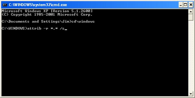

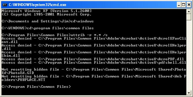

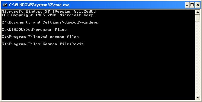

Default Here is the info from Microsoft on DAO issue
Hi ant17
Microsoft article weblink: http://support.microsoft.com/kb/169497
Here is what I found on the Microsoft website about "another application is currently using DAO files"
  • Another application has opened one of the DAO/Jet DLL's. When a DLL is loaded in memory, Windows treats the file on the disk it was loaded from as read-only. This is by design.
  • The read-only attribute of the file that is being updated has been turned on.
Here is the solution:
""""To resolve the first problem, if one of the DLL's that DAO is trying to update is loaded in memory, then shut down all of your applications and tell the setup program to continue. It is a good idea to perform a setup with all applications shut down for this very reason.
The second problem is not as obvious because the setup program cannot distinguish between a file with a read-only attribute set and a file that is currently loaded into memory. The setup program will not identify the specific file(s) that have read-only turned on.
Having the read-only flag set for DLL's is usually used as a low-level virus protection, but it can also hamper the operation of programs using those DLL's or attempting to upgrade them. From a DOS command prompt, go to the Windows directory and type:
attrib -r *.* /s
You may encounter some files that cannot be set as read-only. As long as they are not EXE's or DLL's, it is not a problem.
You may also want to go to the \Program Files\Common Files directory and perform the same procedure because DAO/Jet and other shared components are often installed there as well.""""
If you booted up using f8 (safe-mode) then you should not have any applications running. Do a CTL ALT DELETE to bring up the task manager. Open the Application tab to make sure there are no applications listed.
To get to the DOS command prompt, go to start button, then pick run. type in the word cmd.exe (special dos command for long names use)this will get you into the DOS screen.
Here are 3 jpeg files showing how to do the command lines recommended by Microsoft:
The third file shows you how to close the DOS command window by typing "exit".

Here are all of the command lines (you can copy and paste them into the dos screen command line as needed).
cd\windows
attrib -r *.* /s
cd\program files\common files
attrib -r *.* /s
exit
