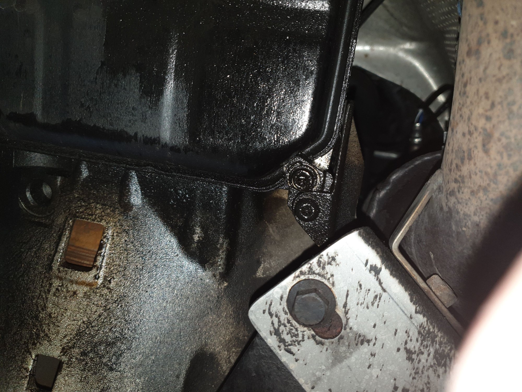

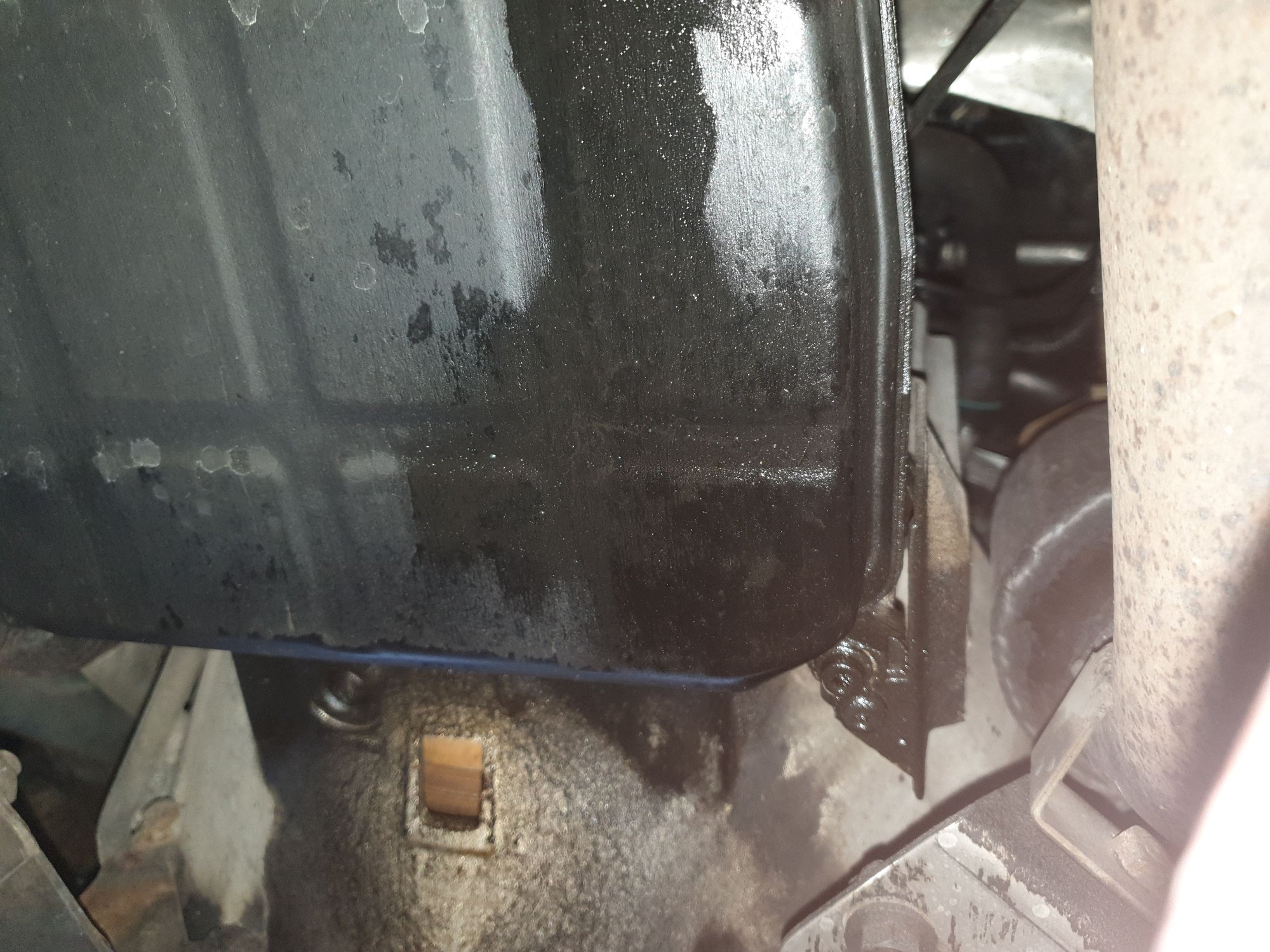

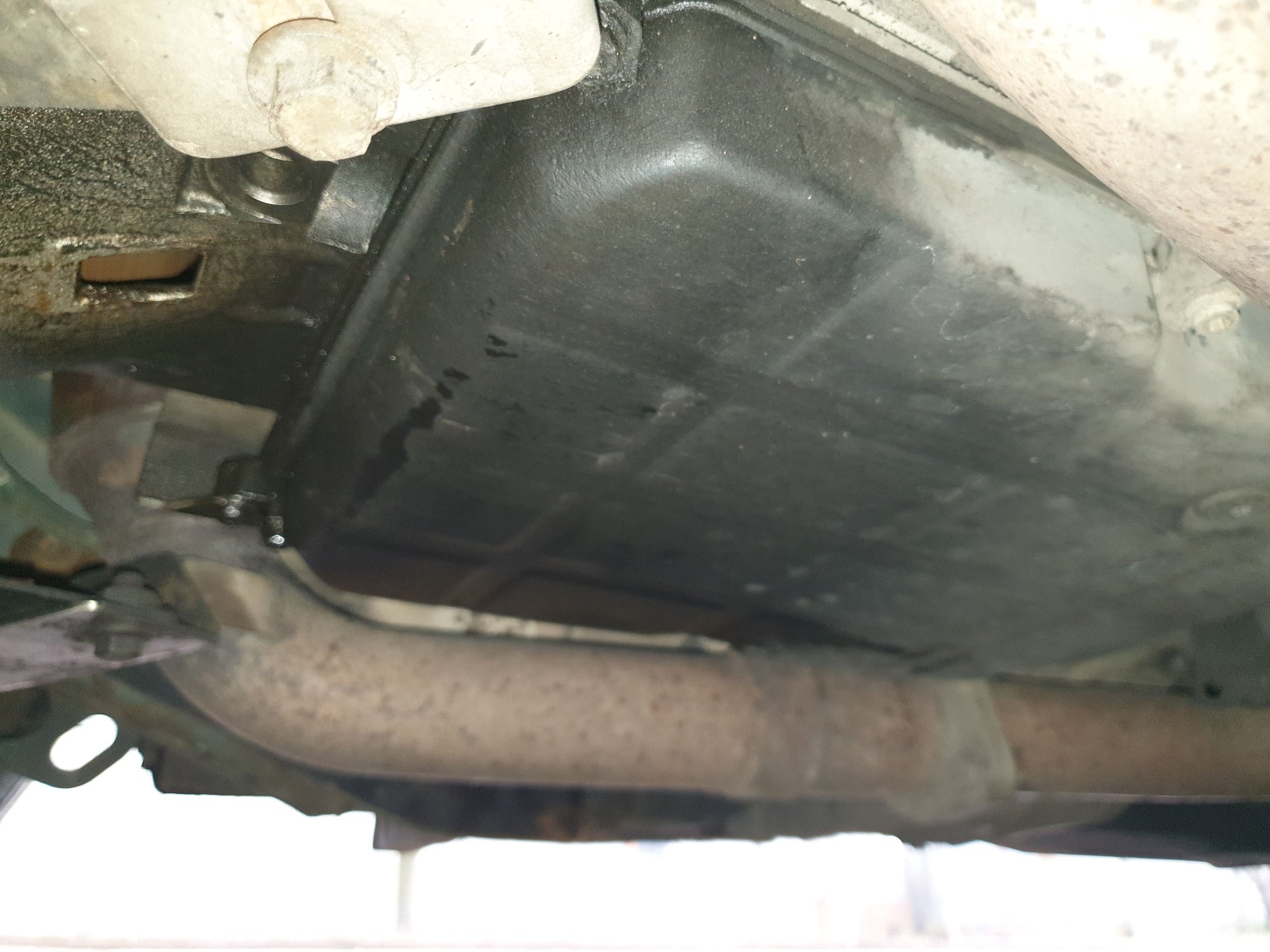

I'm wondering if the fluid level has dropped just slightly over the years and only now is starting to effect it, I cant see any major leaks but il put a pic up of the underside of the transmission and I think you can see a that it may have leaked ever so slowly.
il change the filter and fluid then change it again after doing some miles in it to flush through the transmission. do you think the underpan has been slowly leaking from this picture?

I've had a look under the car today which isn't easy on the jag Jack and the car being lowered slightly, its definitely got a leak I need to get sorted, so I added more transmission fluid to see if it would make any improvements to the tiny amount I added yesterday, and it did improve very much.
so I'm thinking that the fluid is low I just dont know how low, I will order the new filter kit today and a dipstick and hopefully have it done before new year and il update this once it's done to see if the car is happy.

Probably low fluid. New transmission sump gasket to stop the leaks and filter and buy 5 quarts of transmission fluid that meet lt71141 fluid specs . I used non expensive fluid and it worked very well .
