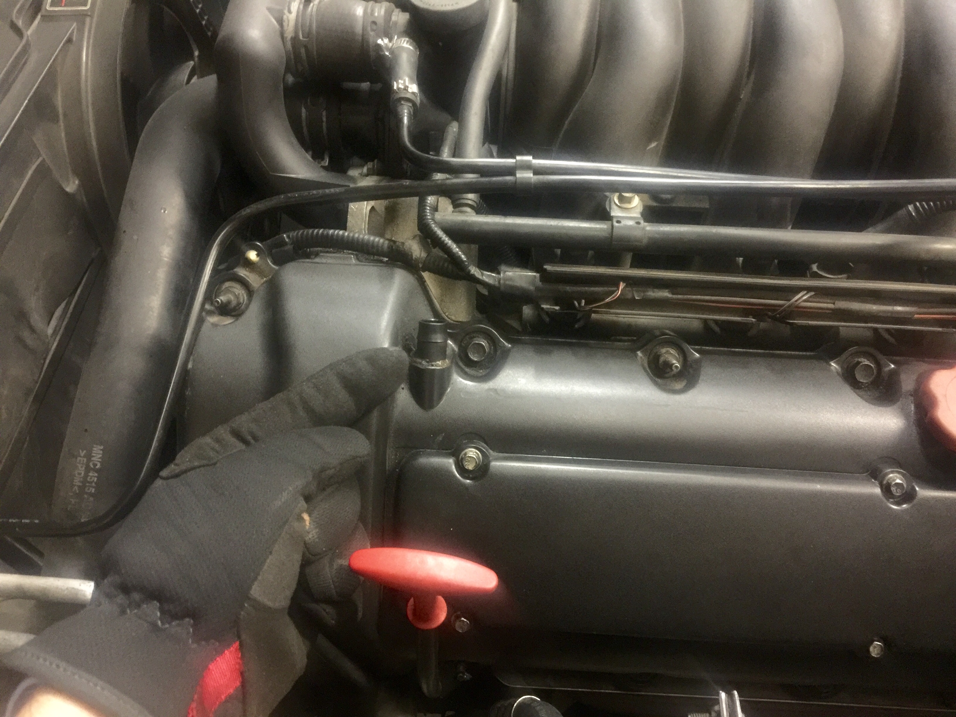

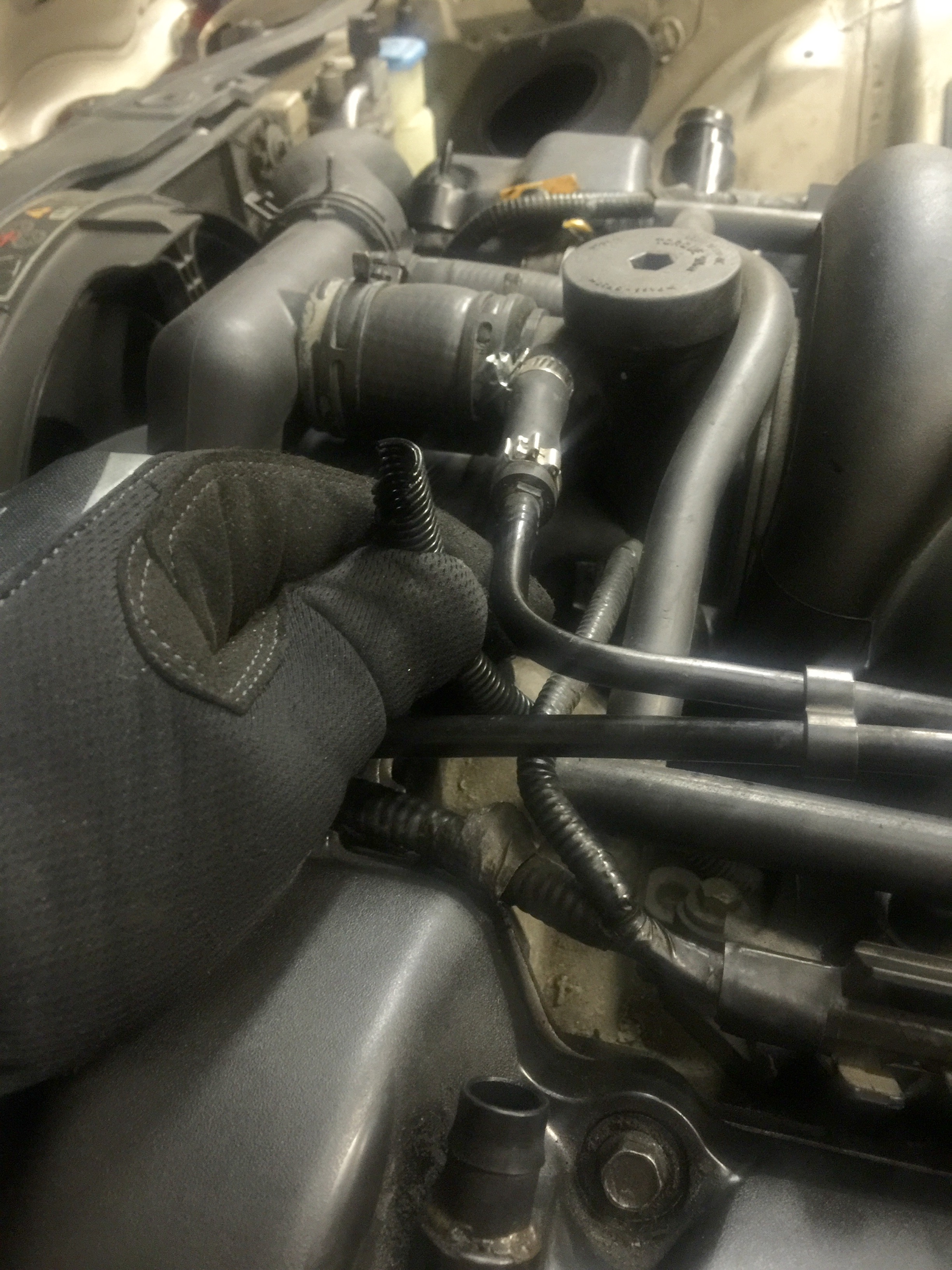

Hey guys...long time lurker, never feel confident enough to really post BUT I need help.
So, recently I decided change the valve cover gaskets due to minor seepage/leak I began developing and thought to myself it would be a pretty straight forward job. Really long story short, I was able to finish the job but I managed to snap a hose that connects to the drivers side.
The questions I have are; How bad is this? What is the name of this replacement piece? And are there any tips or tricks I should take into consideration before I begin tackling this job? Overall, how screwed am I?
I apologize in advance for poorly describing the part and issue it's just that I truly have no idea where to start in regards to the name for this piece. Any information would greatly be appreciated!

I did the same thing when I changed my gaskets. That is the part load breather hose, about $30 to $35 probably. I fixed mine with regular hose temporarily until I got the part in.
Search "part load breather" and you should find several threads on how to replace it. I tied a string from the old one to the new one and pulled it through; it goes to a connection point under the throttle body and another near the firewall. Kind of a pain but certainly doable.

You're not the first, or the last to do this, it's nearly inevitable when removing the cam covers.
$28.00 from SNG Barratt
SNG Barratt - The Ultimate Jaguar Parts Specialist
PN is AJ84880
There are 3 places it plugs in, the cam cover, under the TB and another location near the firewall, it does run under the intake, so make sure the car is cold before you play with it!

Thank you all for the great feedback! I was able to find the part no problem and it only cost around 35 bucks I believe.
