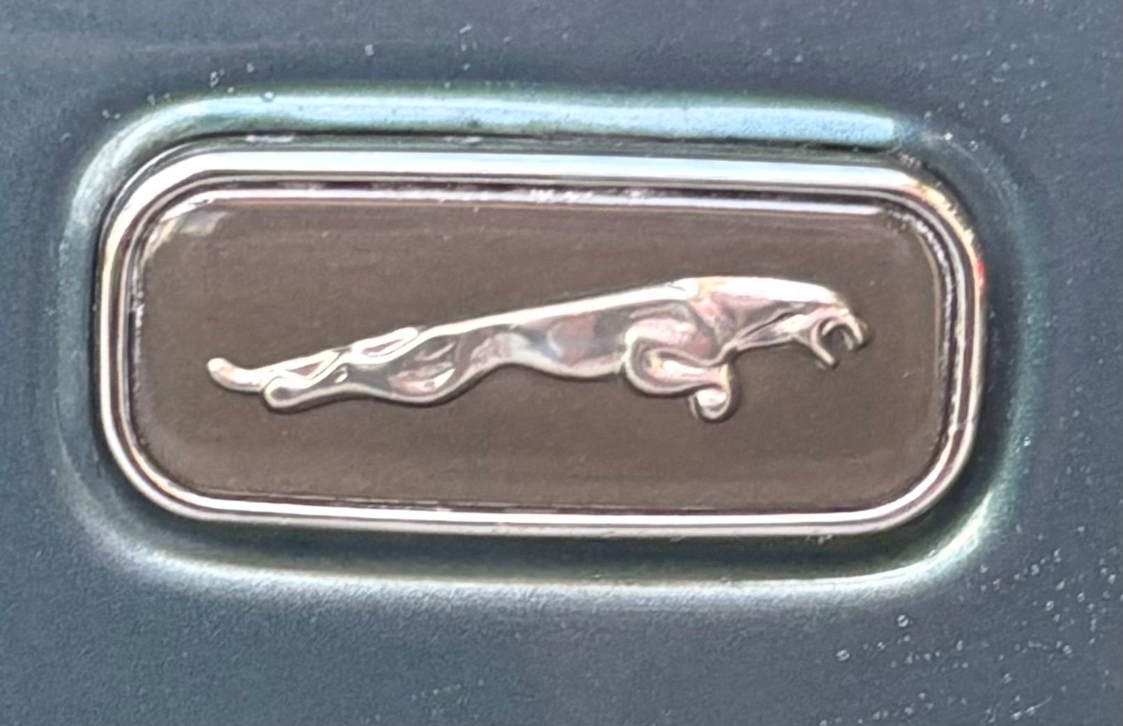

The leaper emblem fell out of it's fixture (the silver part) . All the replacements I'm seeing on ebay include the silver fixture.
How do I remove the the fixture?
This is the passenger side. The black part with the leaper fel out of the drivers side.

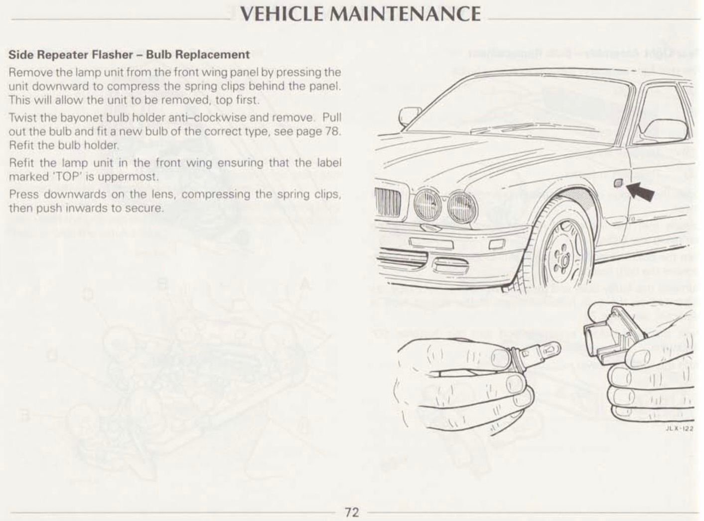

80% sure it's fitted like the repeaters on the X300:

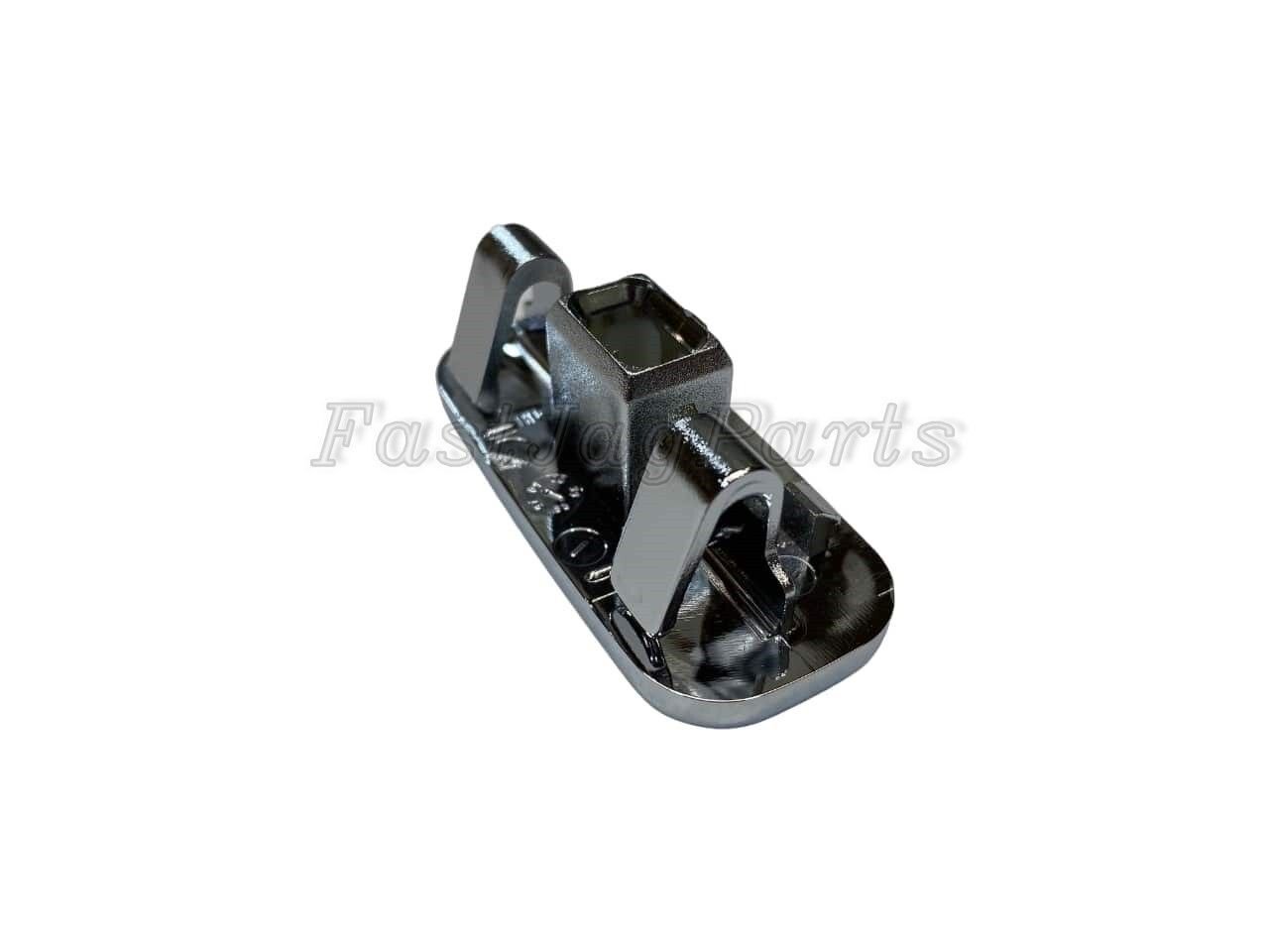

From this eBay listing's pictures, it seems like the assembly clips in:
IDK, I don't have an XJ8.

The full badge does just “clip in” to the rectangular hole in the middle of the depression in the fender, at least the one I replaced did. My guess however, is that if just the face has fallen off that the body of the old badge might have to be removed “from the back” which probably requires removing the wheel wheel liner to get at it (or just leave it in place and try and find a replacement face for it).

"if just the face has fallen off that the body of the old badge might have to be removed “from the back” which probably requires removing the wheel wheel liner to get at it (or just leave it in place and try and find a replacement face for it).
i’m going to try and find a new face.
Thank you! This will be very helpful if I wind up having to replace the entire repeater.
I’m hoping to just replace the black face and not the entire repeater.
