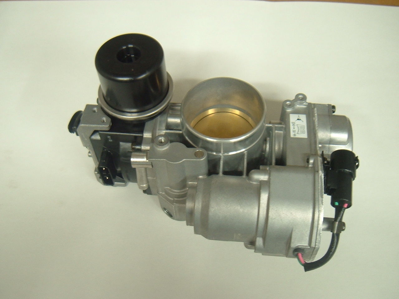

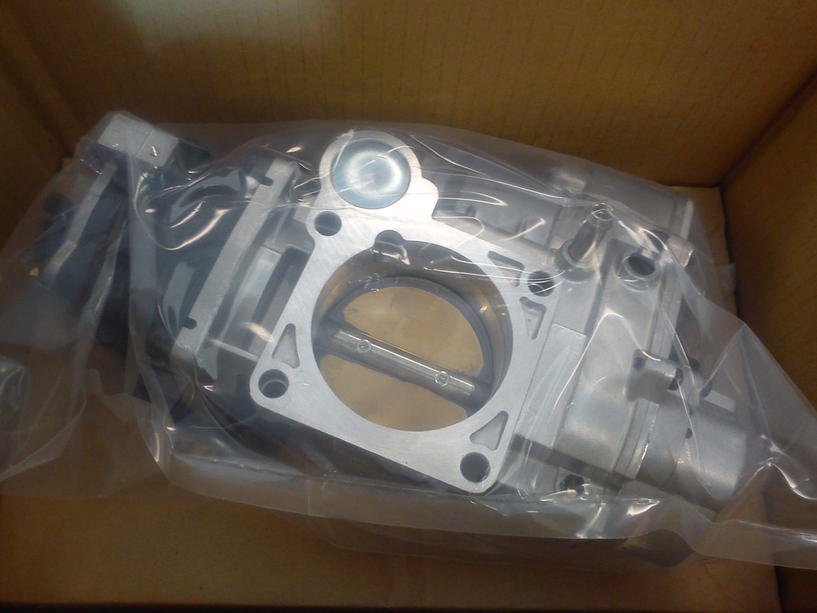

Here is a Photo of it on Ebay:
You need part number C2A1445 throttle body for 2000 to 2003 XJR A27 Engine:
Part no. C2A1445 | Throttle body parts from Jaguar Classic Parts UK
4.0 Litre supercharged XJR from VIN F00103 - Gaudin Jaguar discount price $1757.44.
The Ebay listing by Traunton Jaguar is for XJ A26 Engine (C2A1470ek) - without air assisted fuel injection But the Photo appears not to be a throttle body for Jaguar XJ X308, Correction it probably is a photo of the bottom of throttle body at stated by forum member grandell in post #9 - still not sure photo is C2A1470ek or C2A1445, listing should have shown the top of the throttle body.
You need a throttle body for XJR A27 Engine - with air assisted fuel injection part number C2A1445.
Here is a photo of 2000 XKR Throttle Body (same part number as XJR A27):
That Ebay listing has some errors in it (see the difference - top photo has black Cap shaped part).
