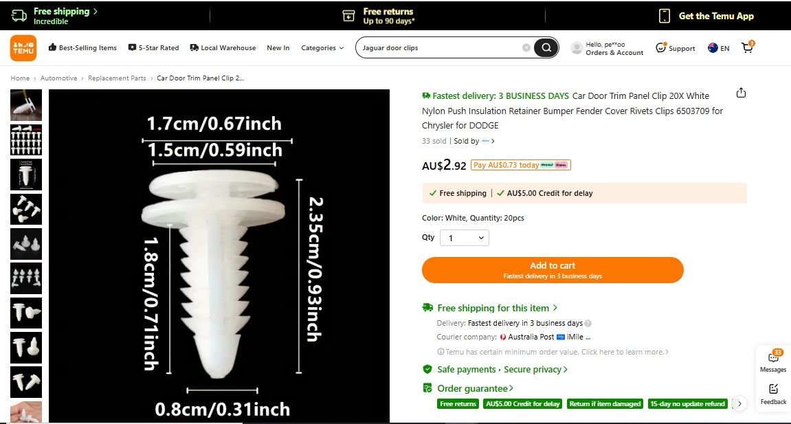

I can't take my own X308 apart now, just to have a look, what clips are being used for the door panel exactly, but I did the next best thing:
I found a youtube video about that:
And the clips, which I do see there look quite similar to those, which I just looked up:
Thus, if you have one of your clips in the hand, you can compare the dimensions, and if they are correct, you know, where to find them.

Thanks Peter for the video and image of the clip. That's very helpful.
