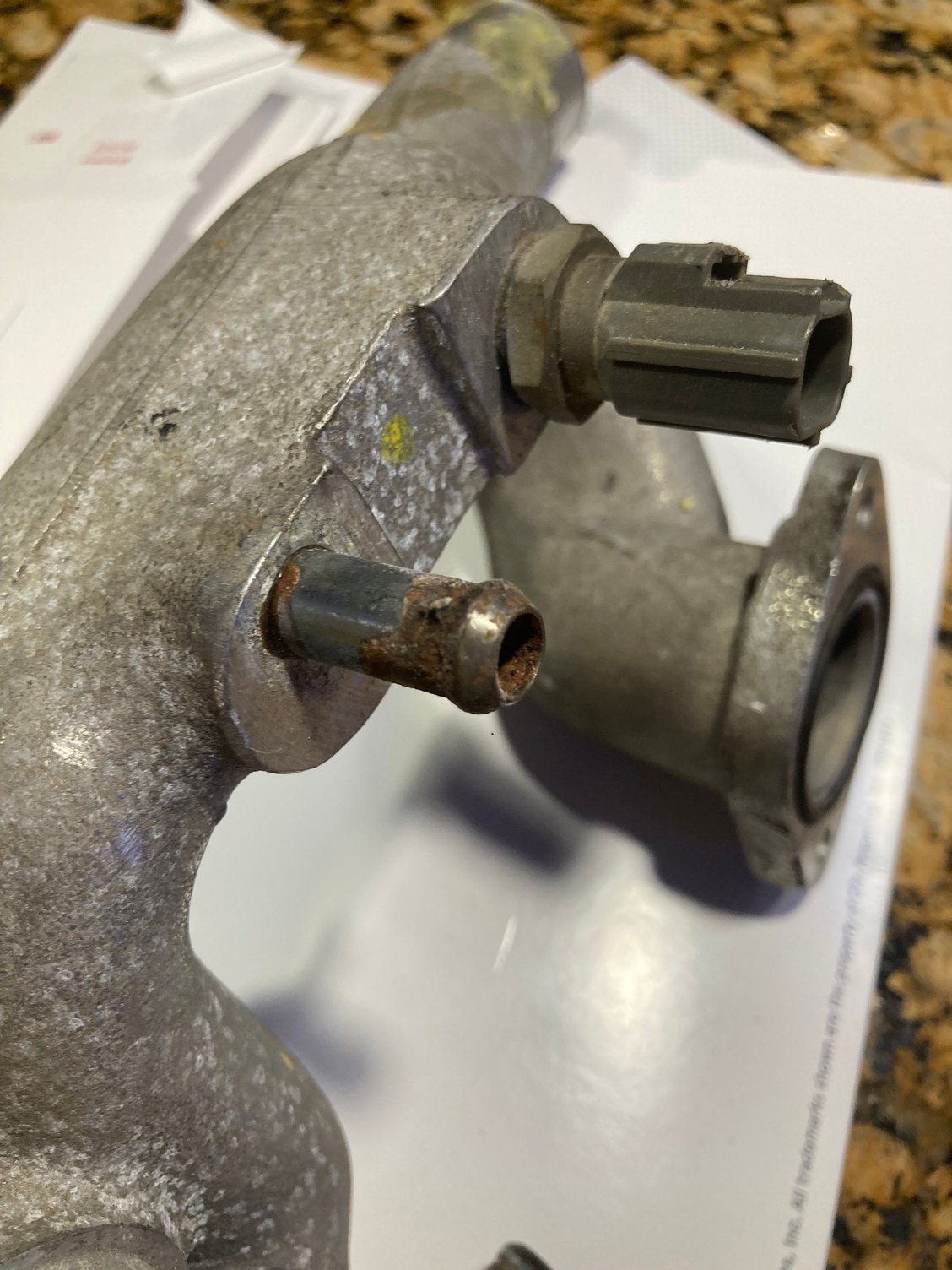

Welp my pipes came in and everything was going well.
I had bought the one that piggybacks on the inlet (I believe) to the expansion tank as a precaution and am I glad I did.
The original shattered like glass when I was removing it so any small bump could have done her in.
The pipe on the passenger side of the expansion tank that heads into the water crossover on the front of the engine just to the driver's side of the coolant temp sensor had a broken lock that I noticed as I was initially looking the job over so I got one of those as well.
I couldn't figure out why that pipe wasn't leaking but when I was taking the original out to replace it found out that the original pipe had frozen into the crossover.
Of course I found out when I tried to install the new one and when it wouldn't go, looked closer and found the (now) broken off piece securely attached.
I've been picking at this and removed about 1.5 orings as well as some small pieces of plastic but there's still some leftovers that will need to come out.
I'm not looking forward to removing the cross over so that I can set it up in a drill press to machine out the stub but that's obviously an option.
I was wondering if anyone knew how the nipple the basket on the pipe clamps over is attached to the crossover.
Is it threaded or pressed?
There aren't any wrench flats so I think I know the answer but before I try with a vicegrip I thought it would be good to ask here...

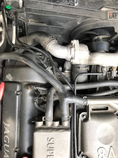

It would be a good idea, if you would take pictures, mark them up and explain that way, what your problem is...

Peter from Oz, good suggestion, I even had one in my phone so I wouldn't have to rely on my 67 year old brain to keep the pipes straight after I disconnected them...
The pipe I was trying to describe is at the top, left of the coolant sensor going into the coolant crossover...

This is from a 2002 XJR as it has a metal pressed in pipe. My daughter’s 98’ XJR has molded in aluminum like yours has. I believe only the AJ26S engines have an all aluminum molded one vs the AJ27S with a pressed in one.

That's what I was afraid of, with no indication of wrench flats on mine it makes sense it was pressed in place.
Looks like I'll be taking the cross over off so I can set it up on the drill press to clean out the nipple.
Not a big deal since I was planning on changing the coolant at this time anyway.

Apologies for leaving this thread hanging.
I was able to clean the left overs out of the nipple on the cross over by gradually increasing the drill size and turning by hand.
The next problem raised its ugly head when I started up to test the new hardware and found the hose closest to the expansion tank (the one I originally snapped at the radiator) was dripping.
The drip seemed to be a poor crimp on the rubber hose section of the pipe, coming out of the 90 degree connector out of the tank.
