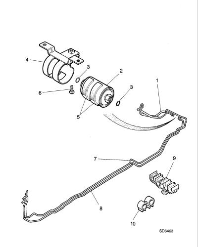

When i was looking at the catalogue i find some fuel pressure regulator
Costs a lot of money but is he does it i will definitely replace it. What are his functions in the system? He is regulating entry or out presuure? Is there any other valves or regulators inside the fuel system what can cause this problem?

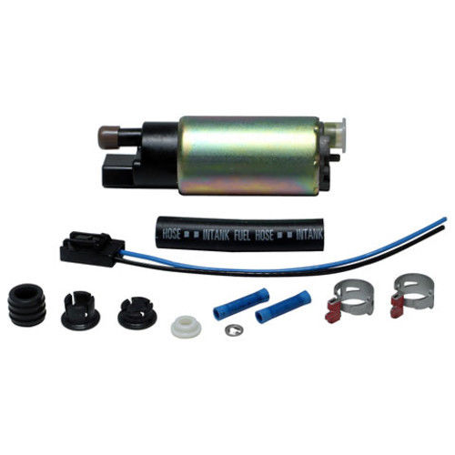

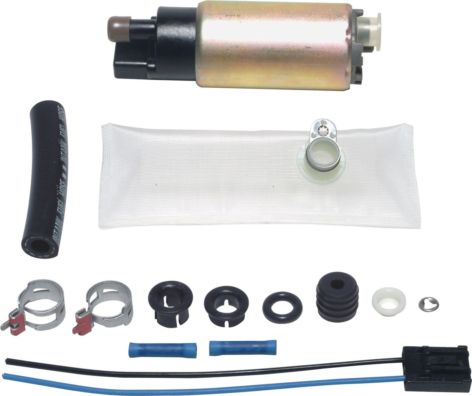

Damn. Official Denso product finder shows me Denso #9510008. What is difference between them? A searched with all part numbers with what bob listed and each is suitable for Jaguars but which one is better to choose?
Old Feb 18, 2014 | 12:08 AM
Rostman's Avatar
Joined: Nov 2013
Posts: 199
Likes: 64
From: Moscow
Looks like i find what's the difference between all the part numbers.
951-0008 comes without filter:
950-0183 comes with filter connection from one end
950-0172 with filter connection in the middle
If photos means what is exactlly selling.

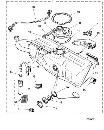

Guys what else is better to order from the parts to replace it when fuel tank will be out. To prevent any other issues i think it is better to replace everything in the place when you take out the tank. Some leads? Hoses?
On this picture a can see some link lead (#20)
I think it is what is melted usualy so better to have it replaced.
Do i need two of this wires? there is two options: white lead and blue lead? How to understand which one it i must choose?
Fuel pipes (#1 and #8)?
Something else?
Attached Thumbnails How many fuel pumps does X308 S/C has?-sd6463.jpg
Old Feb 18, 2014 | 03:26 AM
Rostman's Avatar
Joined: Nov 2013
Posts: 199
Likes: 64
From: Moscow
As i can see from the video on youtube i need both of the link leads
