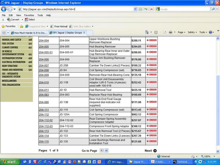

Also looks like the special tools needed are $276 plus (2 camber tie down link tools - JD 133 (204-114). They are listed as needed special tools in the JTIS instructions.
How Much Harder Is It to Install Shocks in a VDP?-xj8-special-camber-tie-down-tool-204-114.jpg
Maybe the forum should think about a member tool rental like the one that Jaguar UK forum has going:
Jaguar Tools For Hire
Says the tool costs is 90 pounds and the rental is 15 pounds.
I do not know how many members would try to replace their own front shock absorbers. It might be dangerous with so much tension on the front springs.
