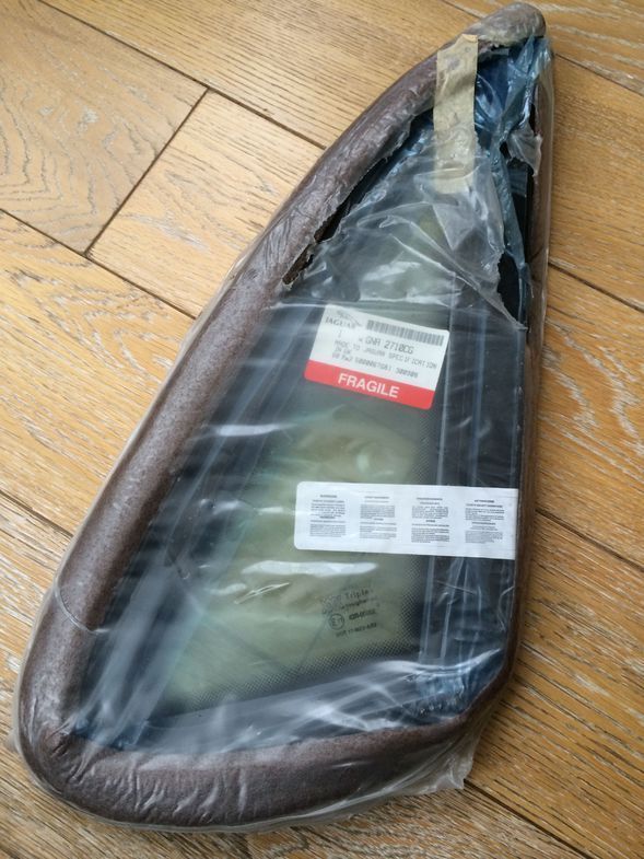

According to JTIS, the rear quarter light is bonded into the bodyshell the same as the windscreens.
They are removed/ installed complete with the exterior trim fitted, and I do recall a picture of a new quarter light and that came with the trim.
So I would go along with your observation that it is glued in place either with double sided tape or some other bonding agent such as silicone.

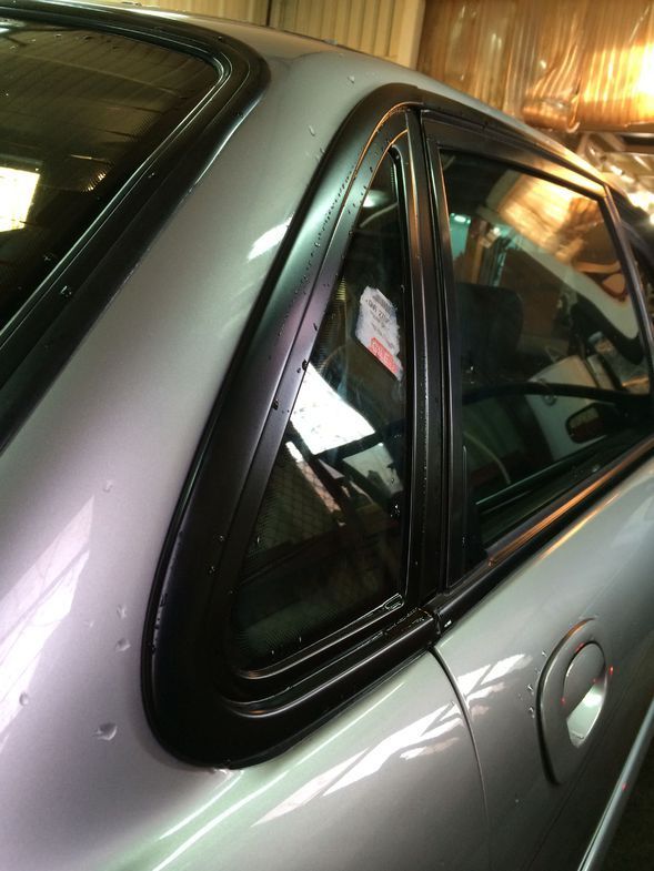

That was why i was replacing my glasses.
http://rostman.users.photofile.ru/ph.../212829893.jpg

That looks exactly like my Rusty! Even the colour and trim is the same!

Yes i have seen the photos in your thread.
That is why i'd purchase a new window.
