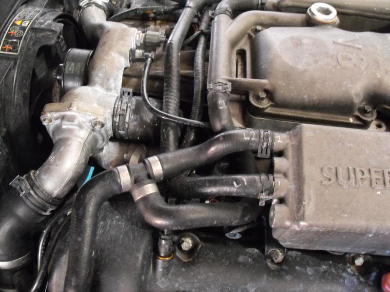

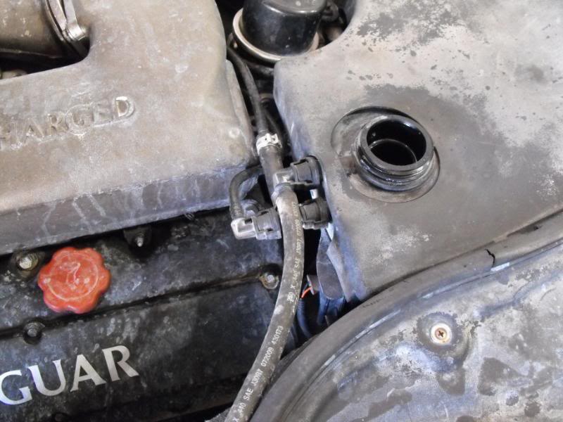

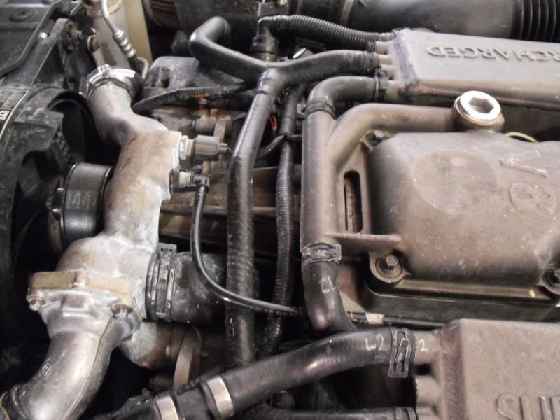

Here are my lines, are they routed correctly( disregard my 90deg temporary line by the rad)

Old Feb 27, 2012 | 03:46 AM
fredd60's Avatar
Posts: 534
Likes: 89
From: australia
Default XJR overheating
When you say that coolant comes violently from header tank, is that when the motor is very hot? You might have a large air lock in the motor. These cars are prone to that if not bled correctly. If you can elevate the front of the car, that helps. Undo the cap with the hex hole in it, on top of the motor. Fill through there, start motor and keep filling it up. Or it seems, from your description of the speed with which the car gets hot, that the coolant is not flowing through the radiator. PO may have changed to long life coolant, which is incompatible with older coolant, and forms sludge. Try pulling off bottom radiator hose, and collect what comes out. If it is sludge, you will have to do some research on the forums about ways to remove it.
May have to have radiator cleaned out too. Keep motor full of water, so sludge doesn't harden.
good luck
Pete

Yes, it only happens when the motor is hot or (operating temp, coolant gauge in the middle) However, before that, everything is fine, heat works fine and no steam, as soon as temp gauge gets in the middle, slight steam from the reservoir comes out and when I rev it, thats what it starts steaming real bad and starts bubbling violently, however, I do hear what could be the water pump impeller making noise, but that shouldnt cause steam, should it? Also, which is the header tank?

Header tank is the one at the top of your picture, with the two small fluid lines coming out of it. No water circulation in motor will cause coolant to boil locally, producing steam.
