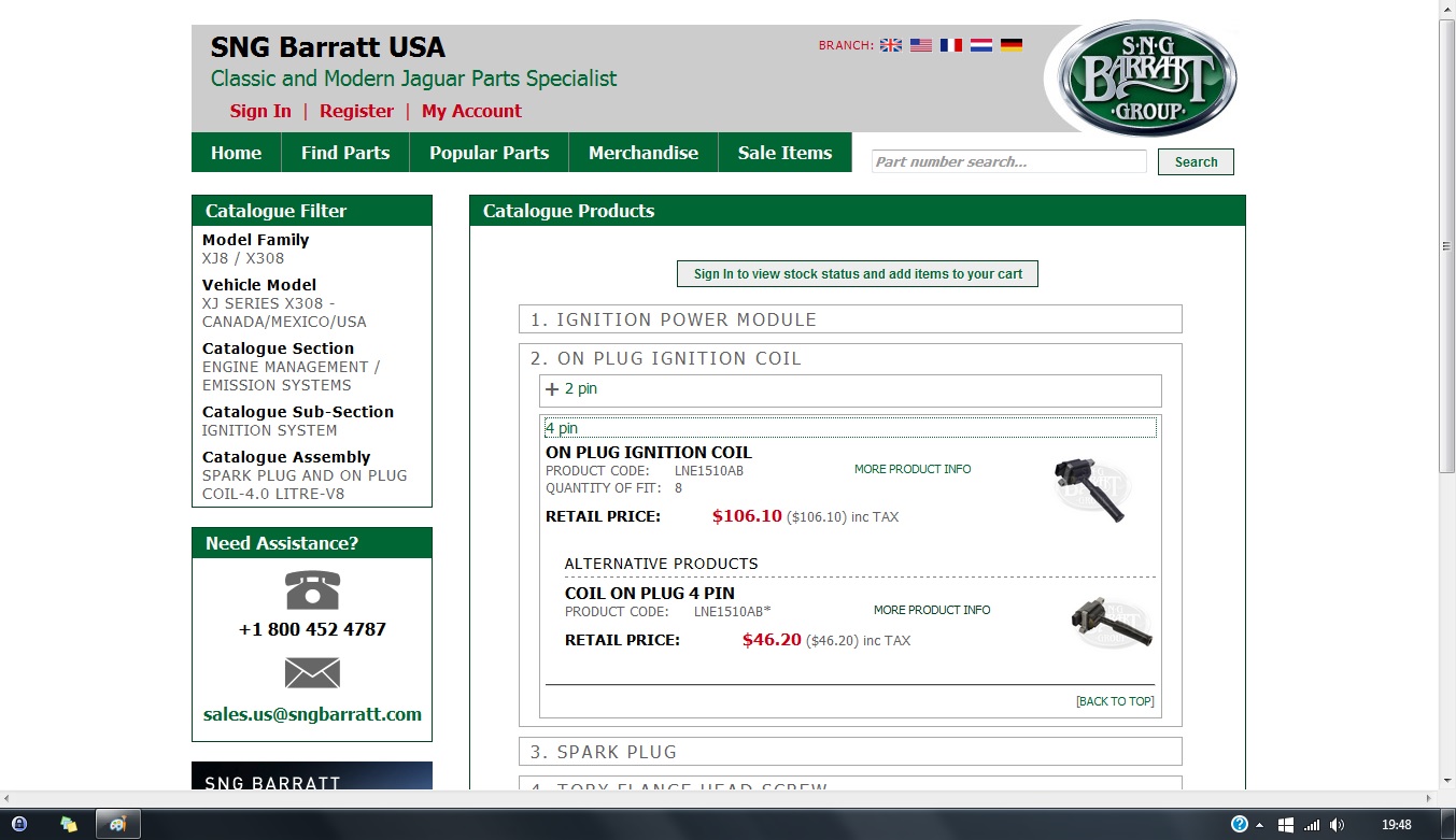

Did you try the forum Sponsors and Vendors? For example:
