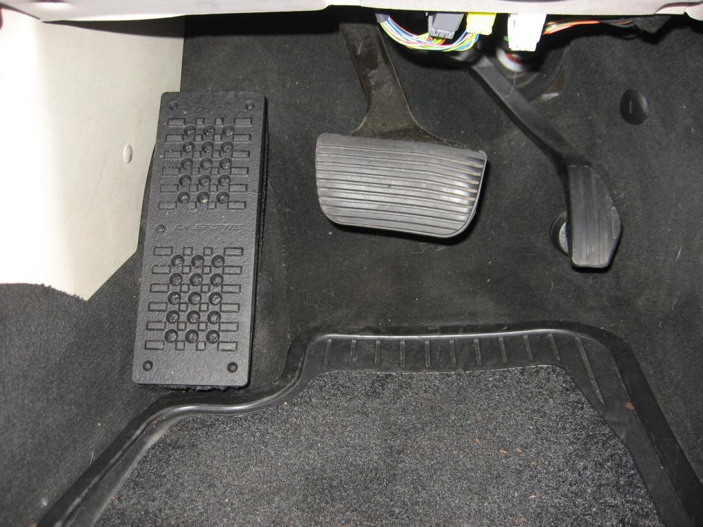

Old Jun 24, 2014 | 07:08 PM
Platinum XJR's Avatar
Joined: Sep 2013
Posts: 379
Likes: 50
Default Done.
I finally found the right dead pedal for my car.
First, I pulled off the factory rubber foot pad.
I bought a large black pedal / foot rest.
Bought some 2" thick dense closed cell foam.
Cut out the foam to match the foot rest.
Used contact cement to attach the foot rest to the foam,
and to glue the foam to the floor.
(I did a test on some scrap foam and carpet first.)
Here is the result:
I need to trim a little of the foam on the bottom of the foot rest as you can see in the photo.
Otherwise it is done.
Gluing the foot rest to the carpet with contact cement works well.
It is rock solid.
Unlike Vector, I did not want to install billet pieces to the gas and brake pedals. The gas and brake pedals are close enough and the foot well is small.
I need a dead pedal that will fit my size 13 foot.
This is nice, comfy, and does not look aftermarket.
The foot rest is 2" high, which feels right to me.
The dense closed cell foam is solid.
Almost forgot: To add some grip to the foot rest, I sprayed it with spray on bed liner. The stuff wears like iron, and gives just the right amount of "grippiness".
Attached Thumbnails Installing footrest / dead pedal:  Need to drill-jaguar6-24-14001_zps96f6ac87.jpg
