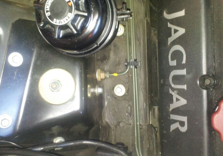

My NOS instructions say to put one of the ground wires to a location that can handle (gasp) 80 amps.
Are any of the bolts in this photo up to that task?
This photo is of the drivers front shock tower area.

Presuming that you are using properly sized wire, and that the lug is also properly sized ...
the shock tower bolts are not a good idea and the cross-member bolts are also not so great
this is because the lug must contact bare metal on its face.
Possibilities include the bolts holding the brake fluid reservoir bracket to the inner fender and the bolts holding the brake booster to the sheetmetal under the cover at the firewall.
In either case, you will have to remove the item, remove the paint down to bright metal, refasten in the following order: sheetmetal, lug, existing, bolt.

After thinking about it, I decided to run a 10 gauge wire from the battery to this wire instead, since this way I know I will have a very clean and solid connection.

It's been pointed out in automotive electrical articles that the body is capable of carrying much more current than any single wire.
If you want to go that far, just run the wire to the grounding point of the ground strap under the chassis on the right hand side underneath the car.

You can also use any of the bellhousing bolts on the left hand side, just like the ground strap does on the right hand side. Be sure to clean off the mating surface with some sand paper.
