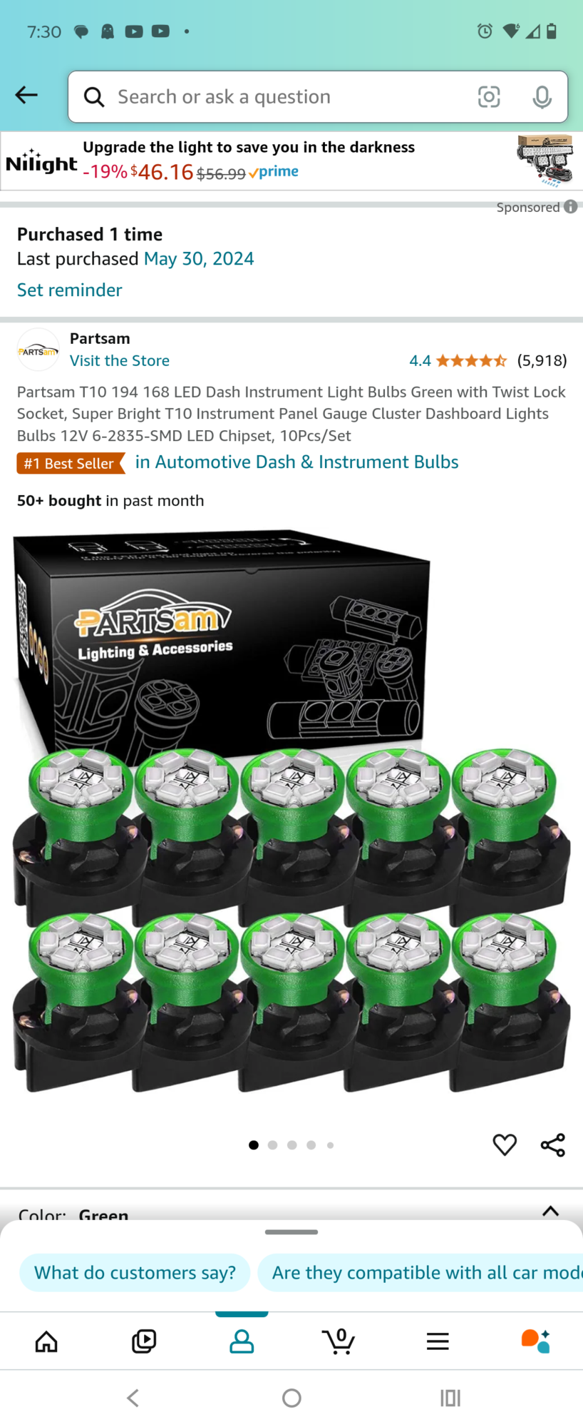

sorry for late response. after some time of having just left them as is they started flickering (bad seating of the neo wedges likely) 1998 plastic in an environment that gets extreme weather like 110f summer time -30 winter time. I believe the issue to be the neo wedges that the bulbs sit into. I have a package of new T10 neo wedges that I was going to try, just haven't had the time as I'm closing on a house and a whole other mess of time consuming responsibilities and what have you. these are what I ordered, I will be sure to update the thread after I move into this house and get It in the garage for winter.
Partsam T10 194 168 LED Dash Instrument Light Bulbs Green with Twist Lock Socket, Super Bright T10 Instrument Panel Gauge Cluster Dashboard Lights Bulbs 12V 6-2835-SMD LED Chipset, 10Pcs/Set https://a.co/d/7WYiyx8

***UPDATE***
Still haven't had a chance to put these in. however I have a different thread going as I randomly started having issues with taillights. I tried a hard reset to reset the BPM and have not had any flickering T-10 dash lights since. the one I prior mentioned as not working is still not working (I'm still thinking a bad neo wedge)

Oct 24, 2024 | 09:37 AM
This one
Reply 0
Oct 24, 2024 | 09:43 AM
Quote: This one
those look pretty long. safer to Go with shorter ones so you know they'll fit in the instrument cluster.
the ones you listed are 23mm tall. the ones I listed are 17mm tall.
Reply 0
Oct 24, 2024 | 09:44 AM
Quote: those look pretty long. safer to Go with shorter ones so you know they'll fit in the instrument cluster.
I'm using them they work fine on my 2001 xj8 not sure what model your car
Reply 1
Oct 24, 2024 | 09:50 AM
Quote: I'm using them they work fine on my 2001 xj8 not sure what model your car
1998 vanden plas. they weren't too long? awesome because that was a concern of mine lol
Reply 0
