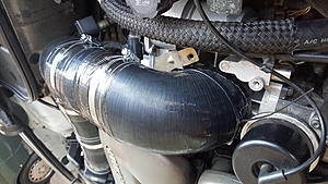

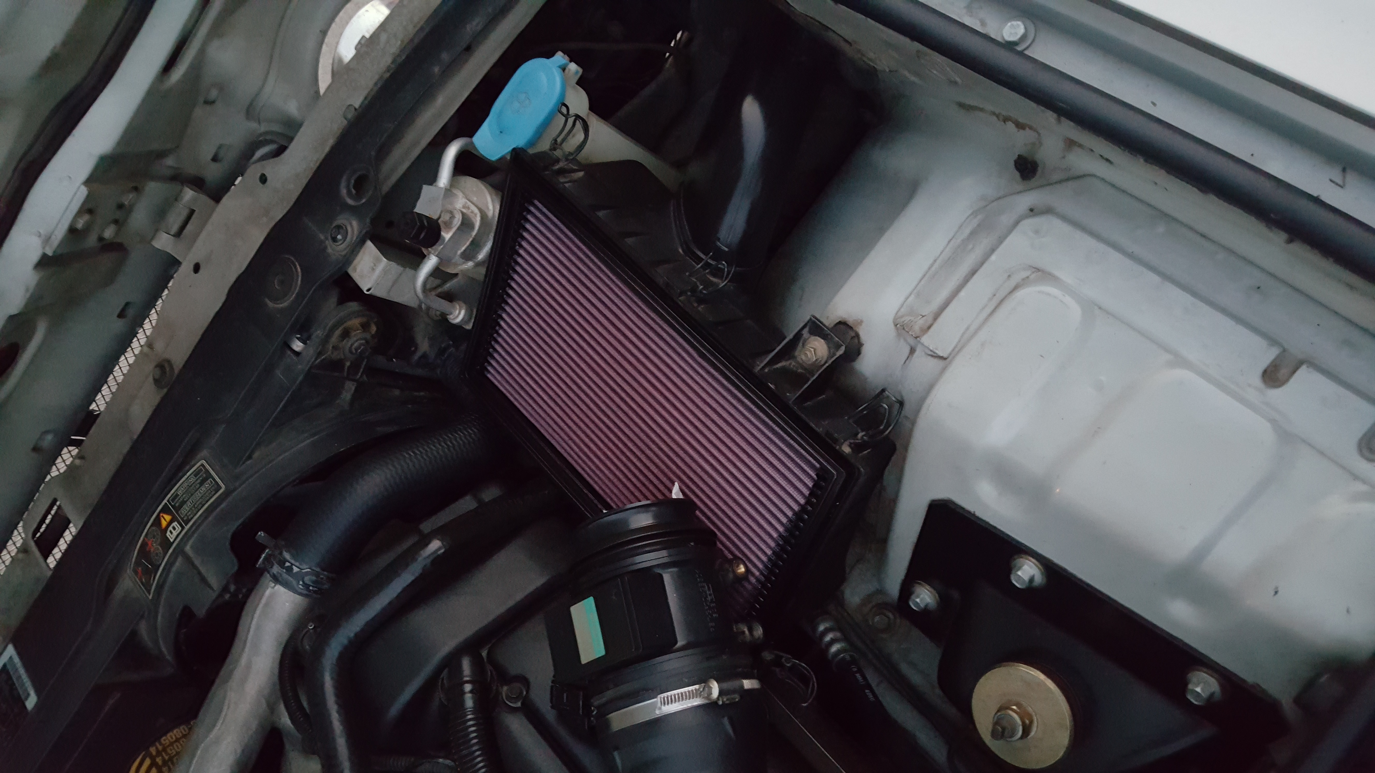

Default Intake Mod complete
I know there are many threads on upgrading the stock intake tube, but here is my documentation:
I bought some 3.5" tubing and constructed my own intake.
Here's what I bought:
2X(3.5" ID 6in straight tube): Intake Hoses, IntakeTubing, and Intake Clamps - Intakehoses.com Silicone Sleeve 3.5" ID X 6" Long - Gloss Black
2X 3.5" 90 deg bends: https://www.siliconeintakes.com/hols...-90-p-416.html
1X 3.5" 30 deg bend: https://www.siliconeintakes.com/30-s...30-p-1089.html
4X 3.5" steel joiners: https://www.siliconeintakes.com/turb...ing-p-380.html
Along with some black duct tape, a very sharp box cutter, a 3/4" vacuum hose, 4 hose clamps, some plastic connectors (from autozone), and some zip-ties.
I had to mash 2 of the steel joiners to make them oval-shaped for it to clear the hood; otherwise, the hood will not entirely close and will dent the hood (learned first hand). I also used the factory throttle body gasket except I had to cut the lip a bit for it to fit properly. I used the factory connector to the crankcase for the ventilation and cut the rest of the tube off and attached a 3/4' vacuum hose to the factory connector and at the other end, I attached one of the plastic connectors I bought from my local Autozone. I cut a small hole with 4 small cuts to the outside of the circle for it to fit.
The total cost was about $180, with about $30 for the supplies and about $150 for the parts plus shipping. I also took me about 5 hours to get everything the way it is now, and it still could use a little more refinement.
Overall, the inside isn't completely smooth due to the steel joiners, but it is a lot bigger than the stock intake. Performance wise, it does feel quicker from about +45 mph and the sound of the supercharger is slightly more pronounced.
Lastly, I bought a high-flow K & N panel filter from ebay.
Any suggestions or question are welcome.

Old Mar 3, 2018 | 07:27 PM
jackra_1's Avatar
Joined: Aug 2014
Posts: 6,264
Likes: 1,764
https://www.jaguarforums.com/forum/x...-%2430-165898/
This is what I did. Around $30 for parts.

AZjag1999. After I posted I realized your x308 intake was quite different so you did a good job!
Most people do this sort of mod to hear a little bit more "whine" from the SC as any power gains are only achieved at high rpm.
