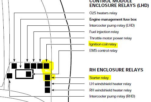

Originally Posted by bigcat01
I got the car back from the body shop about a week ago and the problem still persisted. I rechecked the battery cables, high power protection module, false bulkhead stud connectors and connections at starter and all look impeccable. I printed out 150 pages of a 2002 jaguar xj8 electrical guide to go through all relays and fuses. Behind the false bulkhead stud connectors there are some relays and thought it might be the starter relay. While investigating, the ignition coil relay was not "seated", so I pulled it out and re-seated it and everything has been fine since. I am 99% sure it was that relay ,but it was 105 degrees with about 110 percent humidity. Can anyone verify that the ignition coil relay can cause a no crank-no start problem?
From a quick look at the wiring diagram, it does not appear that a faulty/un-seated ignition coil relay would cause a no crank... however, in LHD vehicles, the ignition coil relay is right next to the starter relay. So it is certainly possible that, in a heat induced stupor, you might have mis-identified which one was not properly seated. I'd suggest you go back, look again and try to remember which one it was. See attached drawing.
