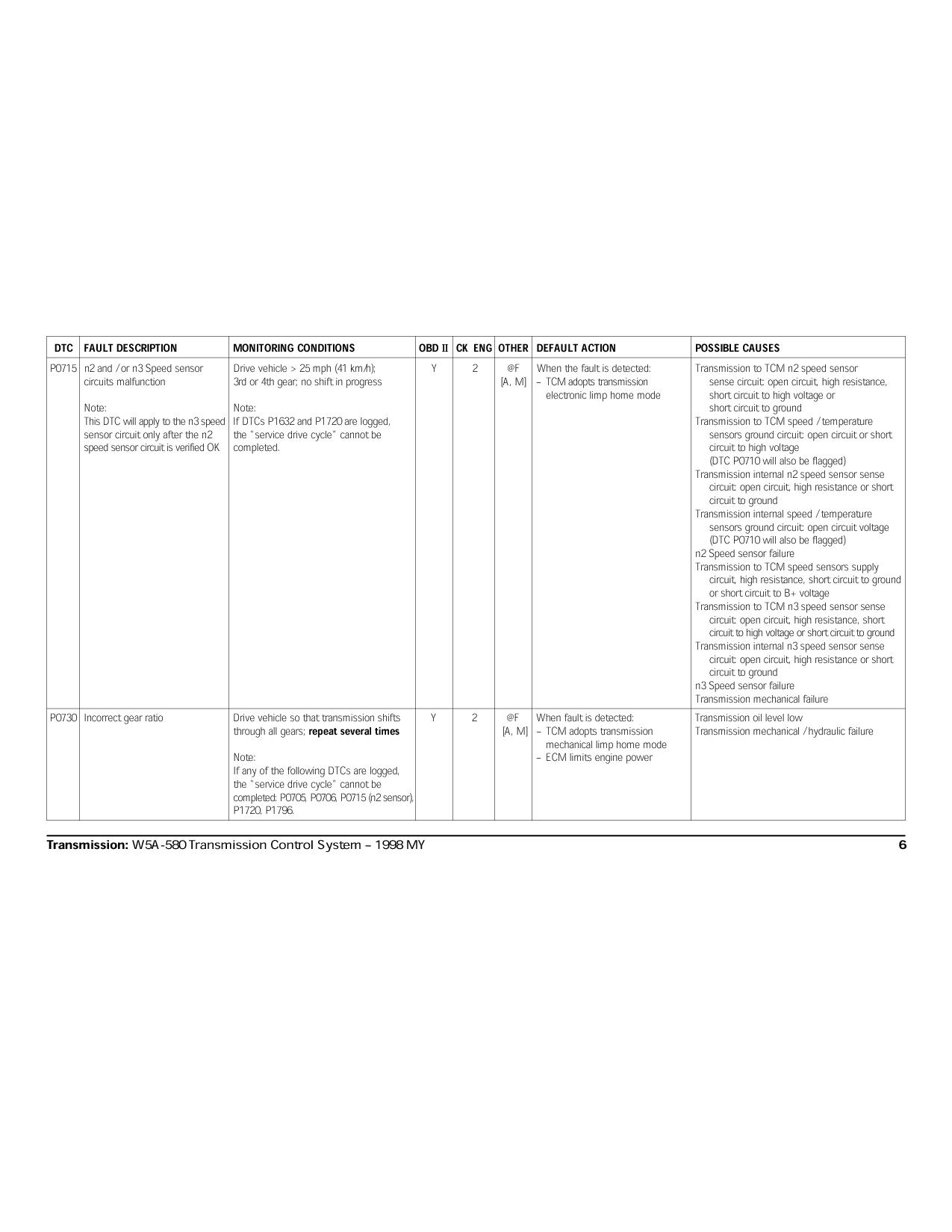

Old May 20, 2014 | 12:03 AM
sparkenzap's Avatar
Joined: Nov 2007
Posts: 4,502
Likes: 1,068
From: atlanta ga
Vincent:
OK, I think by now you have realized that the codes for a Mercedes are not going to be the same as your XJR- The gearboxes are the same, but the control modules are different. Frankly, when you started quoting the mechanic who was telling you some crap about "solenoid 8", I did not care to get in a pissing match with a professional (which I am most definitely NOT!).
Anyway, here is the code P0715 possible causes line from the JAGUAR service manual. Notice there is no mention of any solenoid. It sounds as if either a speed sensor switch, or a wiring connector, or maybe even the transmission module might be the problem. It also implies that the sensor has a "hard error" as opposed to an unreasonable value error, so it can probably be diagnosed with a DMM.
Good luck.
File Type: pdf
