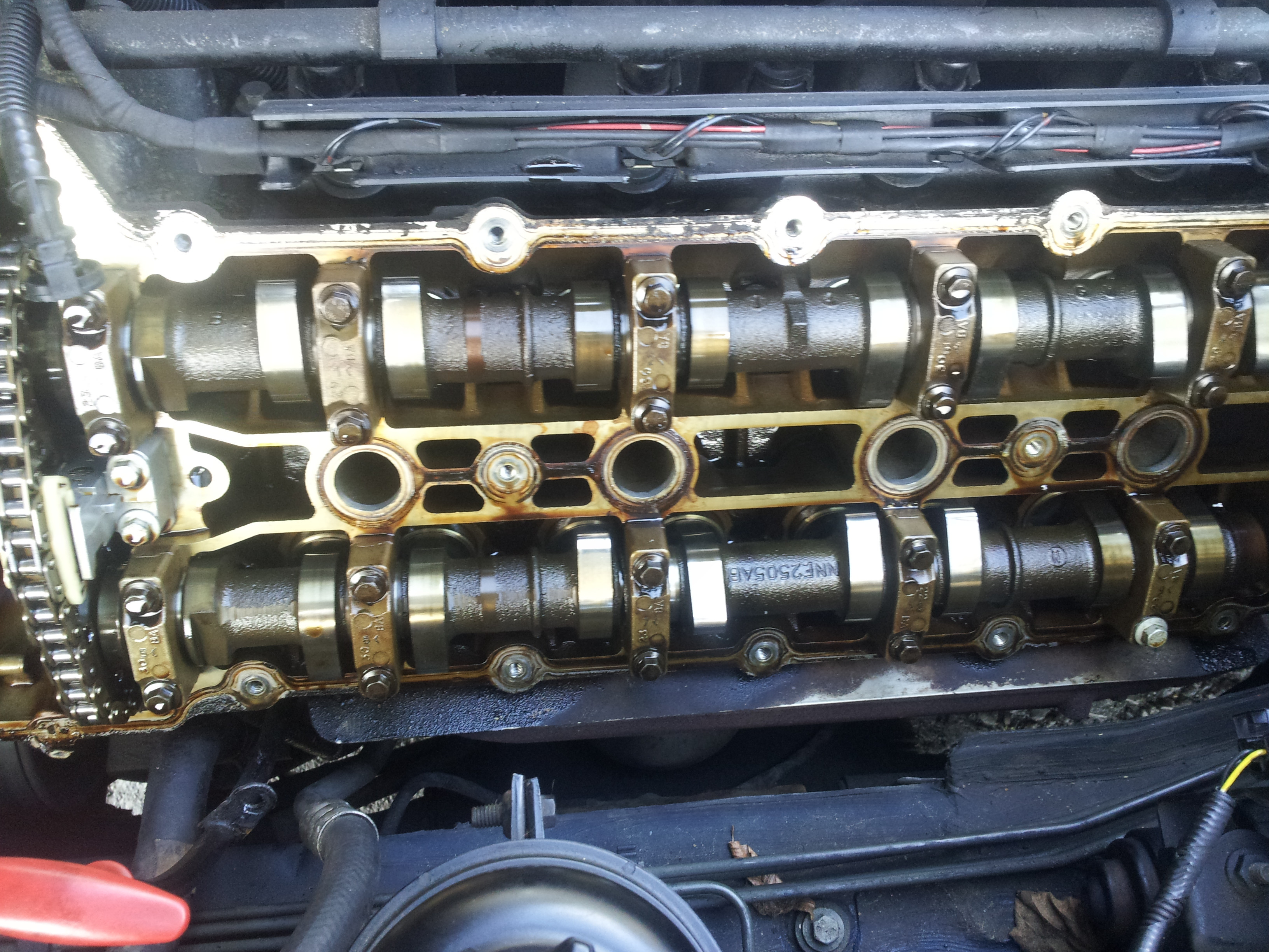

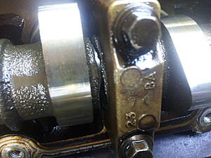

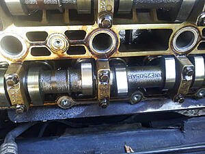

I changed my top tensioners. after changing them, turned it on and everything was running smoothly, without any clicking noise.
Then went for a drive, as I pulled out of my street it made one clonk noise and engine stalled, with me rolling down the hill to find an appropriate spot to pull on the side.
Here are the pictures of this misery:
Jaguar V8 camshaft snapped, Help :(-5kiir2p.jpg
Jaguar V8 camshaft snapped, Help :(-sphc4ln.jpg
Jaguar V8 camshaft snapped, Help :(-s8jtujb.jpg
Jaguar V8 camshaft snapped, Help :(-orb7jjy.jpg
what do I need to do next? Ordering new camshaft and replacing it sounds too easy.
what did I do wrong? :0

Has to be worth a try (assuming the rest of the car is worth the investment). Next time, with the zip tie method, check that the cams are lined up correctly, then turn the engine, from the crankshaft bolt, to the point where the exhaust lobes have the least tension . . .

The killer will be if the valves have come in contact with pistons...if not then putting in a new cam would be easy enough and would sort you.
If you've got bent valves then it's head off and take it from there. If you have to pull a head then it's getting into the realm of engine swap (because you never know if bits of the cam will have made it down to the bottom end...)
I would be pulling the cam out and looking at the break, put the bits together and check are there any big pieces missing. If yes then that puts a cloud over the rest of the motor. If no, and the valves are OK then just put in a cam & drive it....
I do have a bit of a gung-ho attitude to these sort of things...others might see things differently...

Sounds like it's jumped a few teeth, did you prime the oil system before starting it up, I always recommend pulling the fuel pump relay and spinning the engine dry to get oil up into the secondary tensioners as they rely on oil pressure to activate them.
What likely happened is the chain slipped, so it's either a rebuilt head which will cost more than the car is worth, or find a replacement head, and pray that's the extent of the damage. The stall will be valves meeting pistons I'm pretty sure.
As with any engine work, check twice carry out once.

It's unlikely it jumped teeth, the camshaft flats look to be in alignment. More likely it cracked due to the caps being installed and tightened unevenly while the camshaft was under load, not having been rotated to the position of minimum load.
End effect is the same, probably bent valves at the least.

From the first two photos it looks like the cam flats are still lined up. So, it's just those last 5 exhaust valves that are in jeopardy. Maybe the cam got cracked while tightening it down and then broke under running strain. Sad story, but it may not be fatal.

my bad, just read the description and not viewed the damage (via phone) it might not be doom and gloom, I'm sorry if I came across as such - the main thing is to assess the condition of the valves.
If the head bolts have no center pop marks then they can be re-torqued, then center-popped. They can be used twice. I assume you use a torque wrench, which is vital on these engines. Head gaskets are tuppence.
The thing I would suggest you get is a cam locking plate for re-install of a s/h or original head with new cam. Not an expensive tool and as the op found the cams are hollow this is why I can't recommend the zip-tie method. Now seen a few of these on the forum.
Mr muscle I'd send you mine if you had more posts, but you can pick the kit up for peanuts on ebay.
Fingers crossed the valves are ok.

It is a bit hard to see, but it appears that the arrow on the number 8 cam cap is pointing toward the rear. This may have been the fatal error...all arrows should point toward the front of the car.

That's a very interesting observation about the cam cap/saddle orientation. I also noticed the last cam cap/saddle has a new shiny bolt in pics 1 and 2 that doesn't match the color of the others. Hmmm, detective time.

Thank You for your replies, I just went to see my car and indeed the number 8 is wrong way around. have not had time to inspect it further.
I snapped one bolt but luckily it came out easily, therefore there is one new shiny bolt.
I will try to go and see if there is any further damage soon, hopefully on Friday.
