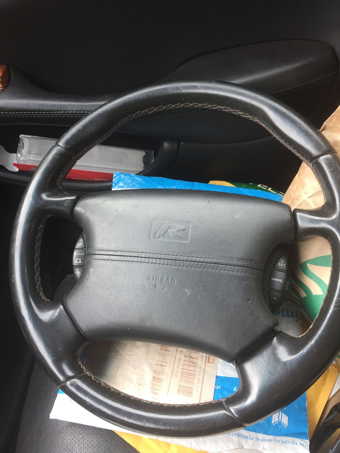

I managed to salvage all the bits and pieces that make an x308 XJR-100 different over a standard one with the exception of the suspension.
Does anyone know if the steering wheel is really any different? The bosses look interchangeable and yet I remember reading they're not.
It looks almost identicle to the normal affair with the bur walnut replaced by leather.
The wood on the door capings and dash looks darker, birds eye maple dyed but not as sharp to my eye as the conventional burr walnut. I was going to use it in my car and re sign it- but am reconsidering now.
Id be lying if I didn't say that I'm not a little bit disappointed: the way the 100 fan boys talk about the car as if it's a bespoke item forged at SVO Browns lane. I think it's the fan boys who ruined it for me. Rant over.
Anyway- any help appreciated regarding the steering wheel

Don't remember that being on an x308 .. looks like a later "R" monogram. Also -- don't remember any suspension differences. It was cosmetic engineering with the wheels and brakes added. I had two different ones for a week each each when they were trying to get rid of them.

That steering wheel is from a XJR 100- I took it off myself. The XJR 100 series had CATS suspension and not all the XJRs in the US came with that. Aside from Folks contradicting obvious stuff that wasn't asked- does anyone have any insight into what I asked? Sean?

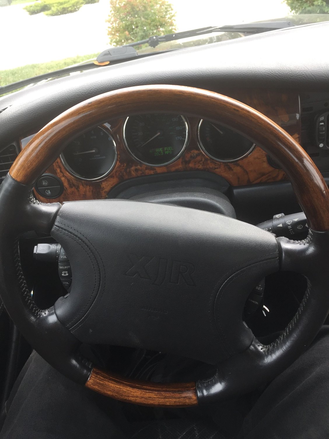

Well, its not obvious stuff .... because the picture did not show the red stitching very well ... did see it when I looked again. Jaguar sold a matching wood steering wheel if you wanted to swap out the all leather wheel -- I can't imagine why there would be any difference in the wheel specification. Most people wanted the wood wheel back then.
All the later SC cars got the CATS shocks.
Sorry that I had the nerve to answer something in a way you did not like .. or was mistaken with a logo.

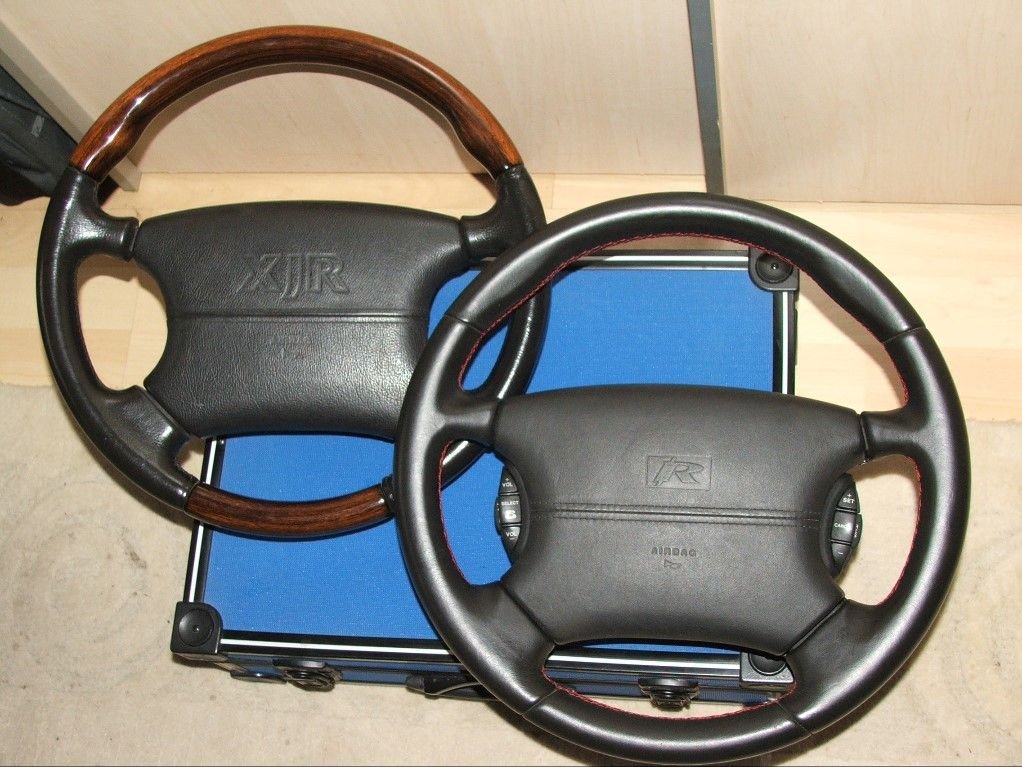

I hope I can clear this up!
It will bolt straight on, they're physically the same base frame - but before you do can I suggest giving the thing a jolly good clean, the stitching can pop again with a red sharpie. R logo airbags are fitted to all XJR/XKR 100's.
If you look at the part number on the foil sticker it should say SVO ; ) (HXD 9181EB)

Have no idea what the 100 wheel is worth -- why not pick up a cheap one from an XJ8? I'm sure you could get one in poor condition for not much money and have it recovered -- seems a shame to destroy an original 100 wheel.

I like those chrome rings around your gauges too. Mine doesn’t have that.
You can find those on ebay and other online sites, I want to say last I saw was about $30 or so? I'm still undecided on them myself, I had them on my 3-series and it really popped the dash up a notch. But with the classic of the wood on the XJ, I'm not sure yet, personally.
You can purchase them aftermarket.
I also believe the later X100 XKR 4.2 vistory and Silverstone editions had something similar if you want to keep it OEM.
