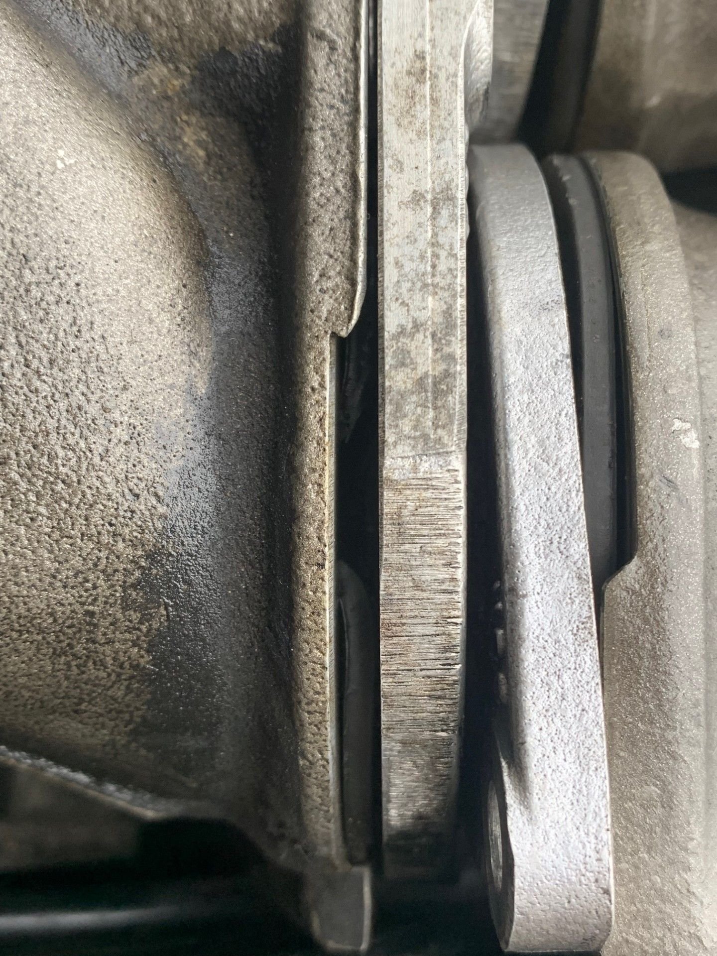

I do know that there is a rip in my throttle body gasket(green gasket) aswell as the 2 circle gaskets that connect the Charge Air Coolers to the Top Plate were noticeably old and torn, and this may be causing the jerking.

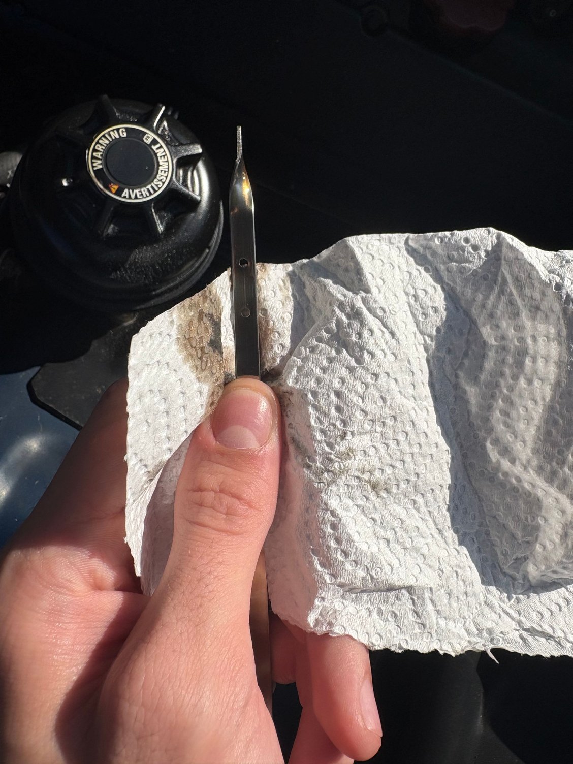

Side question and I feel dumb even asking it, but after the engine rebuild and I put new oil in and everywhere say 6.9quarts of oil so I bought 8 to be safe and only threw in 7 and it’s up to my thumb in the picture. This is after I the dropped oil pan and heads were off.
Should it be between the two dots? And am I loosing power due to excessive oil?

Your dipstick holes are top is max bottom is minimum, you look about a 1/3 of a quart low. I dunno, but did you check the fluid in the SC...and did they put in an OEM spring loaded coupler? It says coupler on their site, but it doesn't say OEM.

When I had it off it held the gaskets on there, so I think it is the new one.
When I was searching online the only gaskets I found said they were for 2000-03 x308s. Can I still use those? And are there any places that are cheaper than $150 a piece?
I’m going to go ahead and take the belt off the supercharger and see if the car still jerks and makes the flutter noise.
As for the oil, it is above the top dot probably a good inch.

So I did some scrounging and it appears the XKR duct seals will work up until 2009...a couple numbers came up...AJ81446 and AJ86925...verify before purchase. They were running about $90-112 ea.

If you have an OBD reader, have a look at 'live data' and STFT/LTFT (short and long term fuel trims) if they are negative you have a boost leak, and you have already suggested the duct seals, if they're damaged that's the likely cause of rough running and an unmetered air leak, hence the ECU tipping fuel in to compensate - I've just fixed one. Located the air leak by spraying easy start all along the induction path, located at the seals.
Pull a half litre out of the engine and get the level between the dots.

Oil level wise, there was a TSB to increase the amount of oil in the engine & a new dipstick to suit. Worth a quick check in case yours has the correct level but on an old dipstick

As for the oil I’m going to check if I have the correct dipstick as Hooli mentioned.

You have a big air leak. Locate and fix before trying to drive the car.

Have you checked your duct seals yet because that is your air leak...
Listen to this....sounds similar??
5 minutes later...
Because of this....
Stop messing around and address what I've told you - IT'S NOT THE SUPERCHARGER.

Hi Sean, yes I have sprayed easy start all over that area and nothing happened. This was without the supercharger running, so i don’t know if it was able to pull enough air from the duct seals to do anything.

it's required...

Hi Sean, I put the belt back and tried it again and still nothing from any intake gasket or vacuum line.
it still starts to hesitate when I put more than 5 pounds of boost or so.
I also noticed on my boost gauge the vacuum would go up and down a little but when at idle
