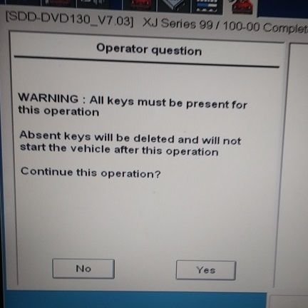

2000 MY onward for North American X100/X308 use MEGAMOS 48 Rolling Code.(From VIN (F00035))
As xalty stated, the onscreen instructions will guide you.
ALL KEYS MUST BE PRESENT, ALL KEYS NOT PRESENT WILL BE DELETED, DO YOU WISH TO CONTINUE? (hit 'tick' Y N)

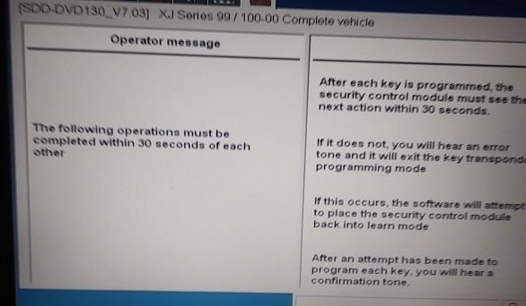

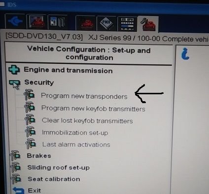

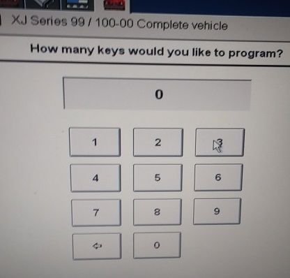

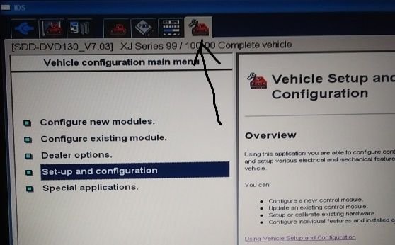

So, for completeness, here’s the procedure to program the key(s) when you have the cut key and the proper transponder (along with ALL old and new keys):
Go to the tab in IDS (arrowed) and the highlighted section:
That will take you to Security:
And, IDS will take you through the rest:
This is pretty idiot-proof…
