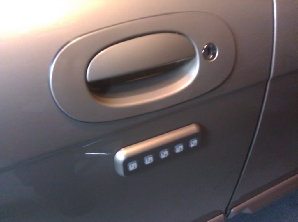

Got my keypad installed.
Wanted to put it on the boot, next to the license lights, but the metal was not smooth enough. I went with the door instead...

Got it off ebay for $40! I kept searching knowing I had seen this type thing befor, and it finally showed up.
It worked GREAT, does door and trunk. But it is working sparadocally now... The battery in the pad on the door is going. Turns out these are 10 year old units, and the battery is old. So next step is to replace a nonreplacable battery... I WILL PREVAIL!

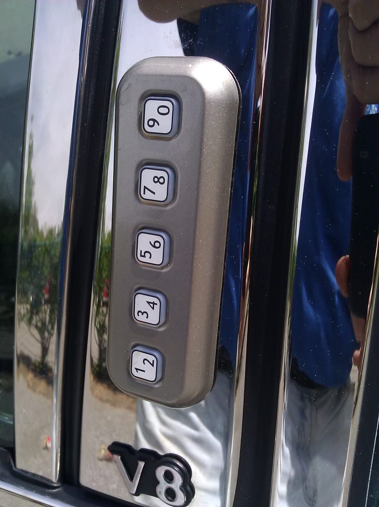

Update for keypad project... everything works like it should, a wonderful addition to my cat. The negative was the battery was old in the transmitter, but with a couple flat blade jewelers screwdrivers and a three minutes, replaced the coin style battery no problem.
The performance with the unit on the door was not good. I believe it was because the receiver was directly shielded by the door itself. If I moved the transmitter away from the car, even 15-20 feet, it worked fine. It did not work reliably when mounted to the door. As you might imagine, this caused just a bit of frustration.
The solution was to mount the transmitter on the drivers door pillar, as shown in the photos below. It now works flawlessly, and I am confident to leave my keys in the car when playing sports, hiking, whatever. Plus, I think it looks good too, painted gold like the car. Total cost for this was less than $100, installed by a local shop.
