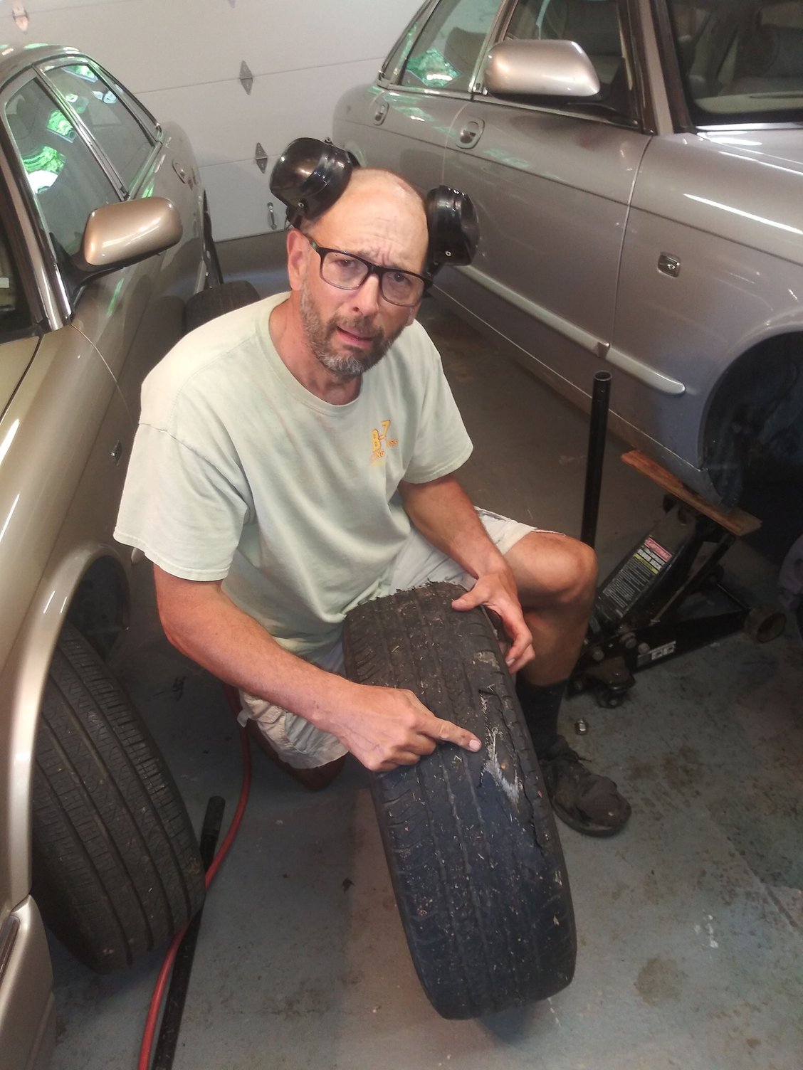

SUCCESS!
Look at that tire! Ridiculous ! Embarrassing. It was on the right rear. I had alignment done a year ago.
I put 4 new tires on ( 70 dollars each, mounted and balanced, Douglas tires from Wal Mart, rated to 119 mph) and.... all the problems solved. Its a new car. I had it up to 90 mph and didn't realize I was going so fast, smooth and quiet. I cant believe the solution was so simple.
I'm still going to install new front shocks and stabilizer links, (rubber torn) and get it aligned.
NB Cat, Jhartz, steven302 , you guys were right on, THX for the advice. I didn't even think to look at something so fundamental as tires.
I am STOKED, jeff xj8
