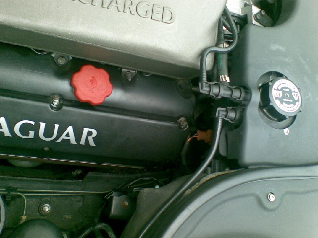

hi all,
I think I found the problem, just to be sure can someone quickly confirm it please.
I think the problem is switched hoses, see the picture (I think they should be the other way around). (I bought the car recently and I'm finding funny things like this)
Old 05-28-2010, 09:15 AM
JaguarXJR02's Avatar
Join Date: May 2010
Location: Virginia
Posts: 663
Received 101 Likes on 76 Posts
it looks like your assumption was right, you need to swap those two hoses, i attached a picture of how they look on my 2002 XJR.
