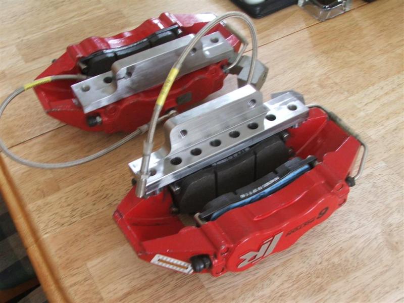

The brakes are made by Alcon. They are 6 pot monobloc on the front and 4 pot on the rear. The bells/rotors are Alcon also, same dimensions as the Brembo discs, so I didn't need to fit larger wheels. I had adaptor brackets made so the calipers fit the XJ hubs. They are the same brakes that are fitted to the XKR-S of 2008. Probably the most impressive thing about the car is the way it stops, it pulls up like a mini cooper, and for a 1.8 ton car, that ain't bad!

A little machine shop just around the corner from me, I took a front hub assembly with the disc bolted on and the caliper. We used a wooden template a member on here loaned me, and made some sketches and measurements. Then went ahead and machined them out of EN 21 steel.
Have you got around to fitting up your Brembo kit? Do they need brackets? Have you got a picture of them?

Sean, I gave up my brembo conversion just because I was not able to have some one fabricating the adopter for me.
about the one you fitted in, they are the same in size as the silver Brembo R kit from jaguar.
I was wondering if your shop can make one for me despite I am from the other side of the pond? Mind the tell me the cost of making that adopter?
I can send a drawing so you can take it to a shop near you. The material alone was expensive. My brakes are bigger but lighter than the brembo kit, used for racing.
