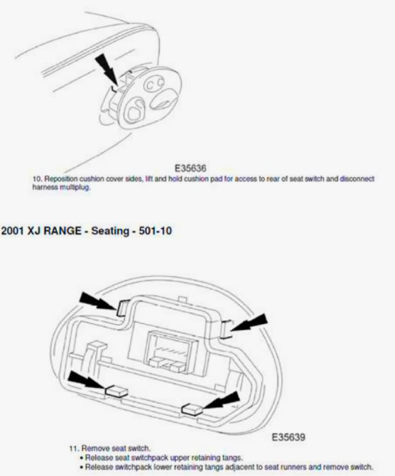

Here is a page I copied from the JTIS showing the Front Seat Switchpack and tangs:

The first image shows the switchpack with the switch face plate on. From the side of the front seat - looks like you have to release the multiplug located near the rear of the switchpack and pull the face plate off with the multiplug male end intact.
The second image shows the switchpack with the switch face removed and now the tangs can be viewed and you can release the tangs to remove the switchpack.

Yes, but the surrounding pages in JTIS also call for removing the seat & cover, releasing the multi-plug from the back, and accessing the tangs from underneath the seat cover.
That's the part I'm trying to avoid.
