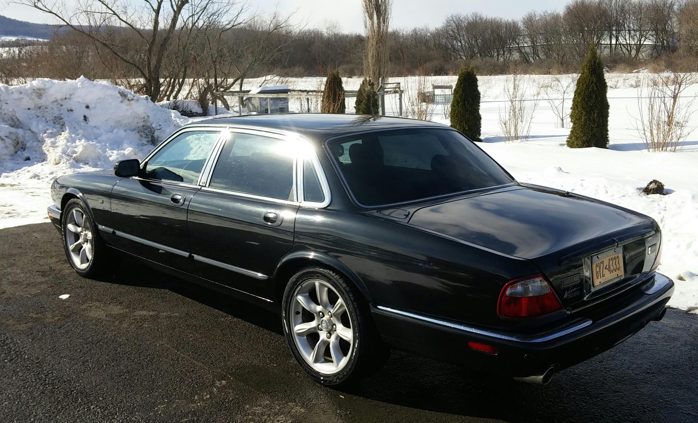

Thought I should put a cleaner picture up too, took this one last year:
