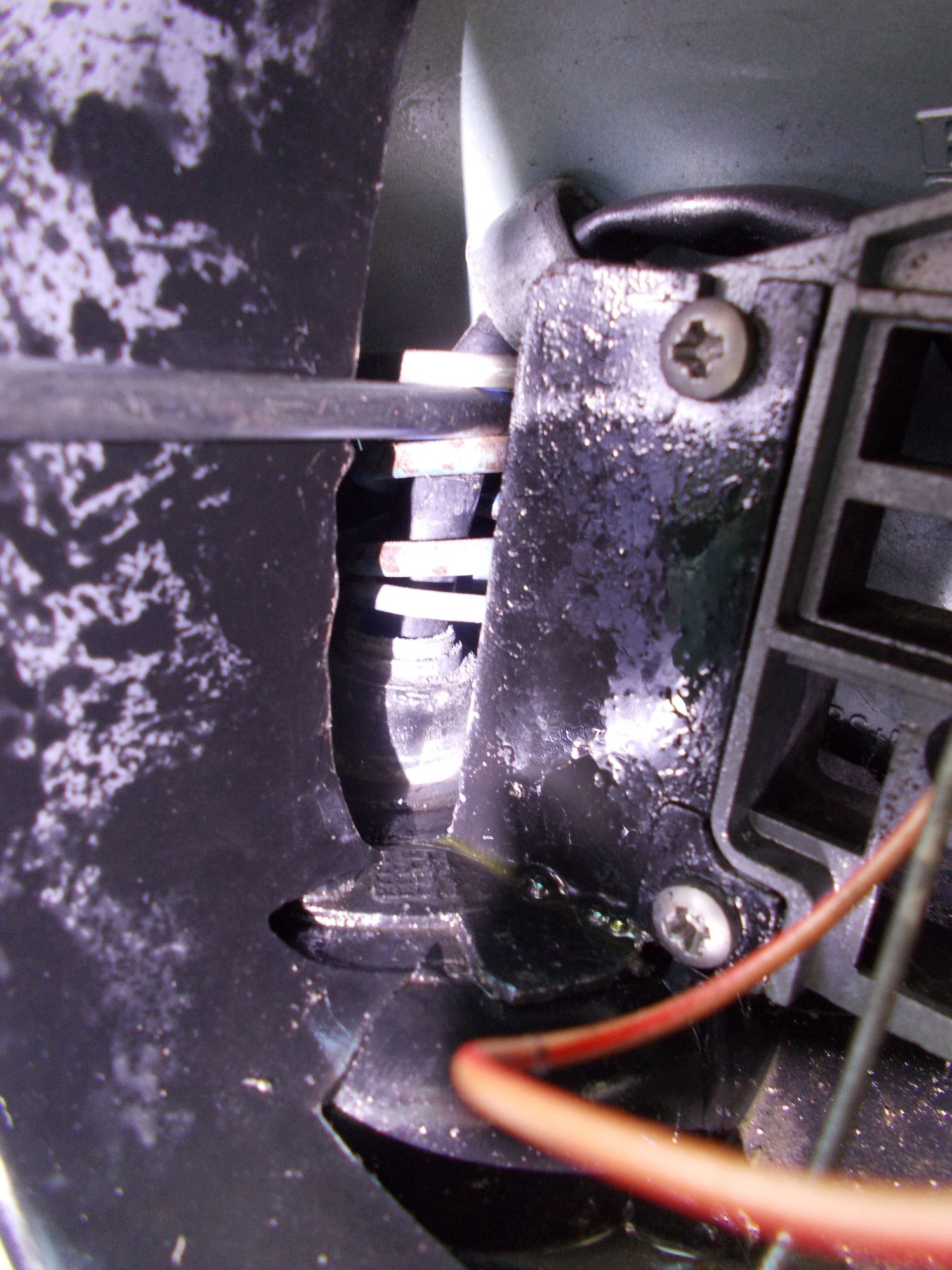

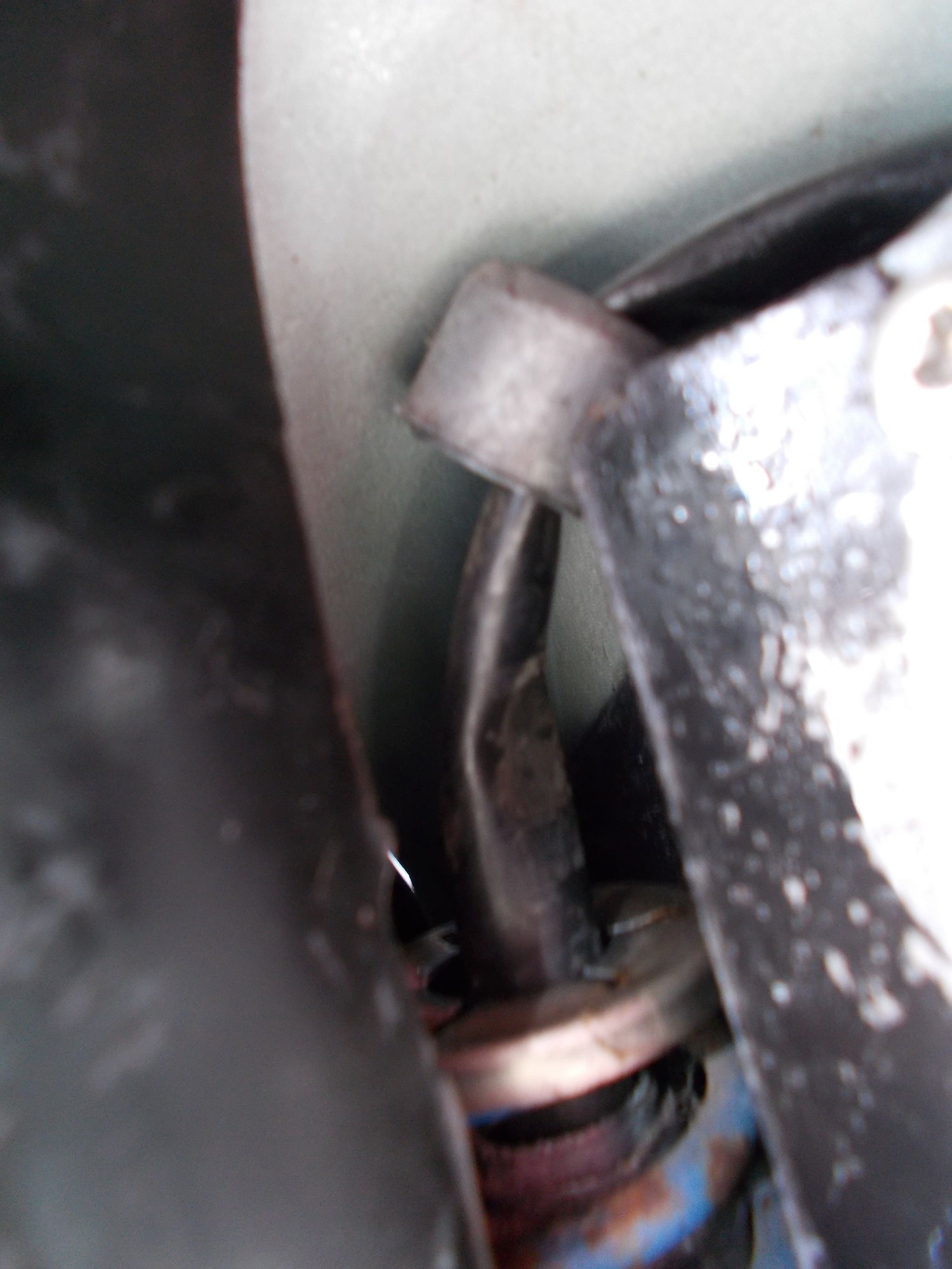

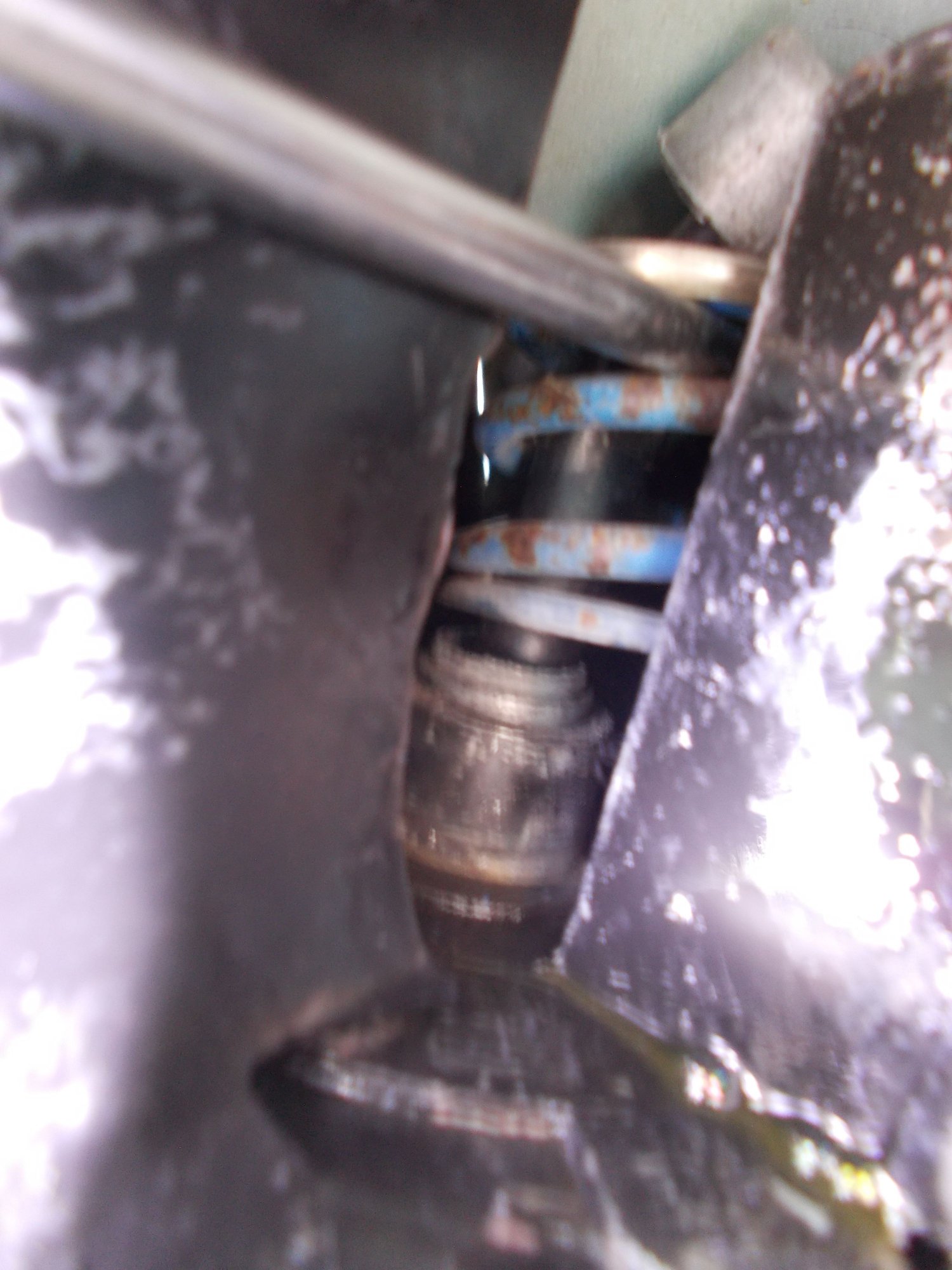

Old Aug 30, 2025 | 06:12 AM
Dude.Day's Avatar
Joined: Jan 2024
Posts: 64
Likes: 16
From: Stoke-on-Trent
Default Is My Door Mirror Dead
This system has AGAIN LOST MY TXT explaining the series of three pics updating my thread. I will not keep retyping txt so you'll have to wade through the pics without explanation. Hopefully the pic descriptions give you the final diagnosis . . .
The Autopsy Report.  From bottom Up - The mount around which the spring seats - the bottom (3/4mm) of the post that the star washer grips onto - the spring - the top outside edge of the
The Autopsy Report. From bottom Up - The mount around which the spring seats - the bottom (3/4mm) of the post that the star washer grips onto - the spring - outside edge of the "star" washer that cups the spring at top - the top portion (12-15mm) of the beheaded and severed mounting post .
The spring mount and post showing the powdering as the
The spring mount and post showing the powdering as the "star" washer toiled on its slow death execution
The beheaded portion of the top post.  May he rest in peace in the certainty of a life well met
The beheaded top portion of the post. May he rest in peace in the certainty of a life well met.
Last edited by Dude.Day; Aug 30, 2025 at 06:20 AM. Reason: Txt explaing pics was LOST AGAIN by your systems
